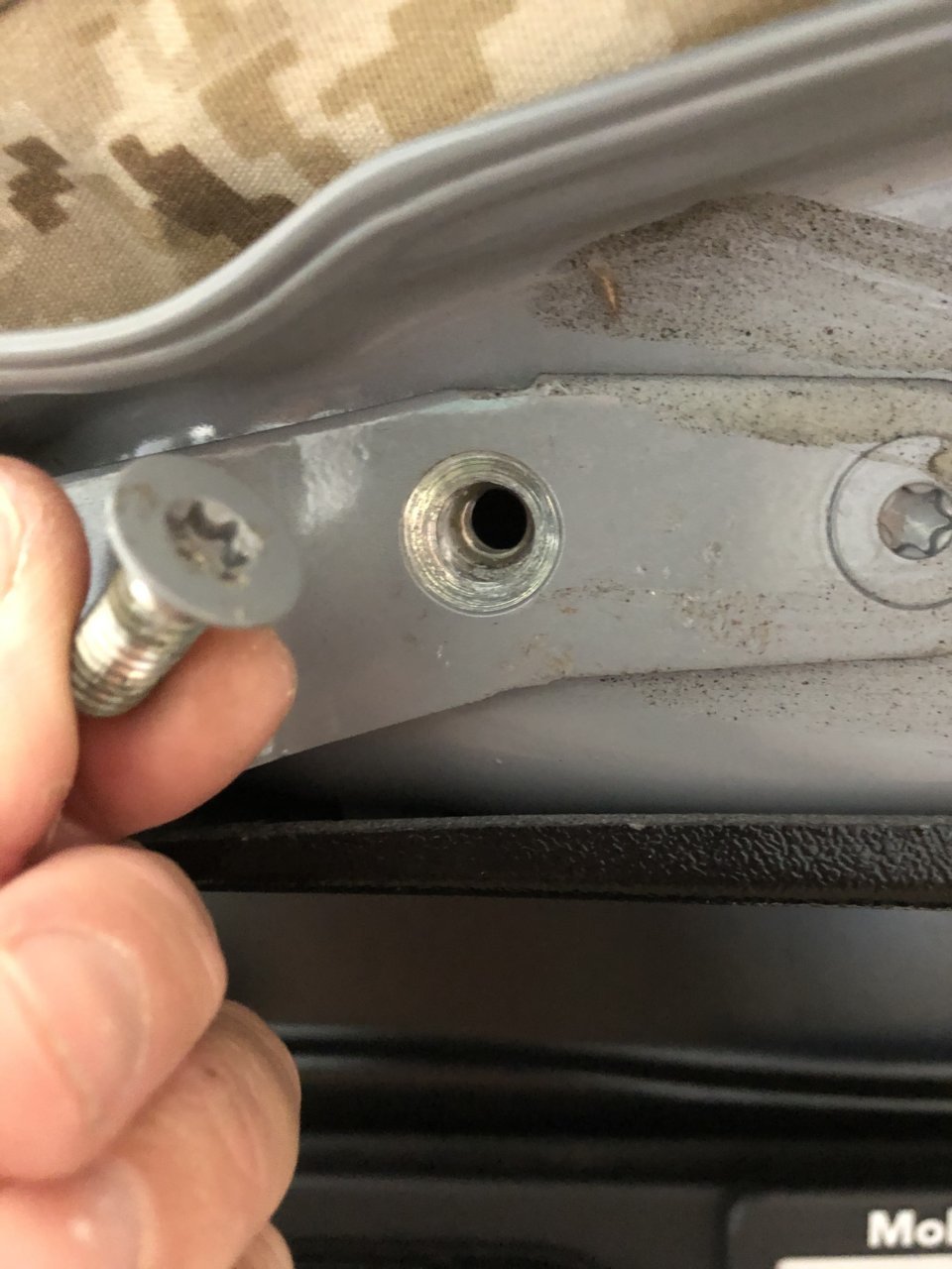

    Got the bolt out no problem - just pop the the right side out and let it hang. However, there wasn't enough clearance around the OE housing to get the new part in. I've got about half of the part thickness in available clearance.

    This has happened once before, it's probably a clump of sealant that is put in there in the factory. Can u send me a pic of the gap?

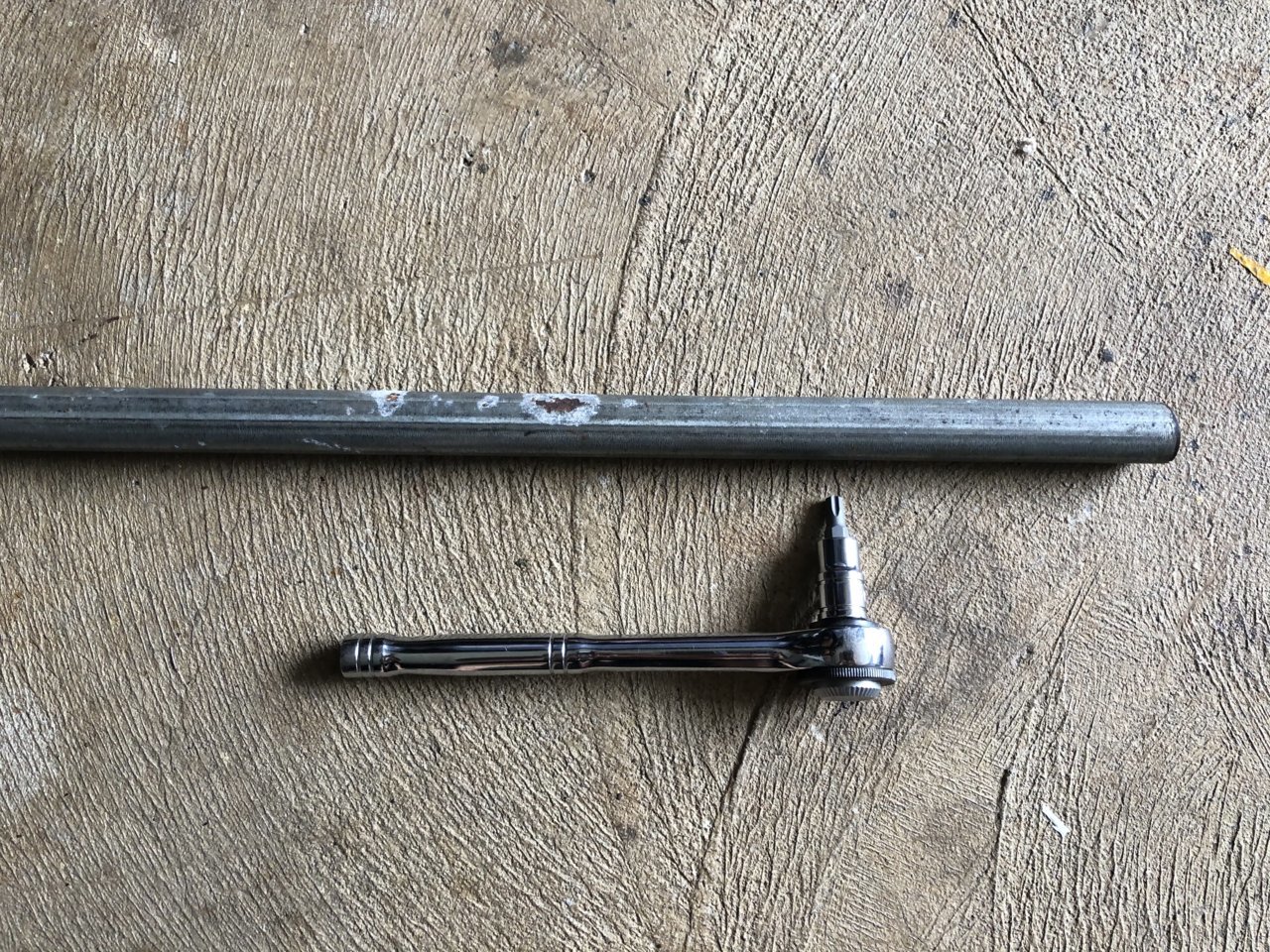

    So I’m waiting for mine in the mail but figured might as well try remove that bolt... removed the tailgate and placed it painted side up in the bed. Put a nice thick blanket to protect from damage in case I slip or something drops.
    Used a hammer and a small punch and hit the bolt about 12 times. Then I hit the metal bracket that the bolt is bolted to.
    Went slow with a 3/8” socket/wrench and a pipe over. Came loose in about two minutes. Make sure to press hard into the bolt keeping the driver flush and points on the torx drive from slipping.

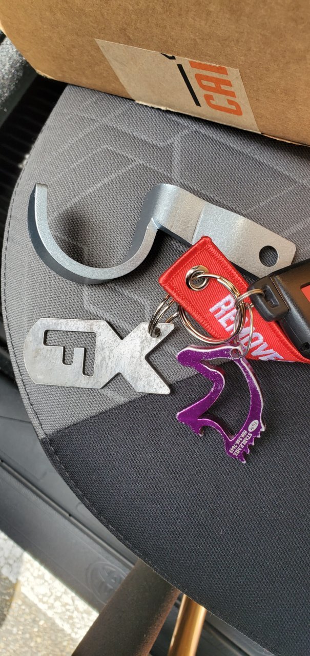

    Got mine today, matched the paint as well.
