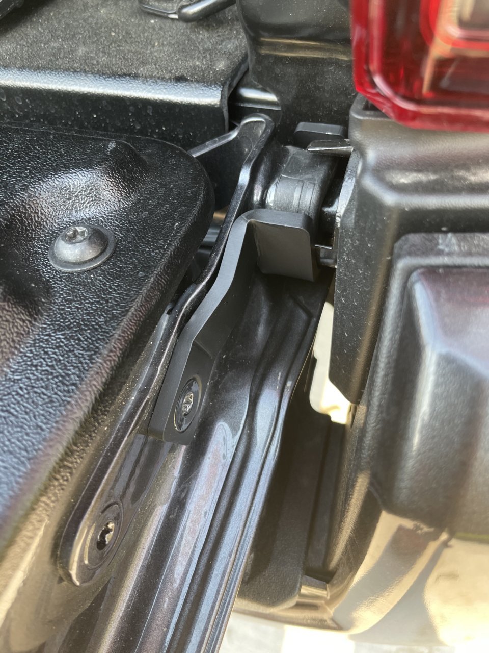

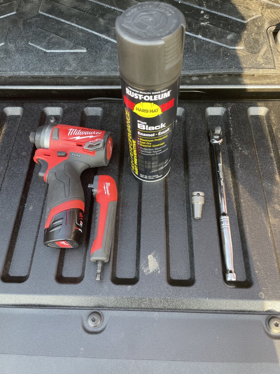

    Got my bracket in today.
    Unfortunately I got an almost welded T40 bolt from the factory.
    First attempt was with my Milwaukee M12 Fuel impact and a right angle adapter (didn’t take the tailgate off) but it wasn’t moving.
    Second attempt was a 3/8 breaker bar with a 1/4 screw bit adapter while holding the tailgate at a 45 degree angle and I managed to break it free.
    Went back to the Milwaukee to finish driving it off. Slid the bracket in and started the bolt by hand, tightened with the Milwaukee again.
    used some rust-oleum flat black rattle can paint.
    Edit: DO NOT LET THE T40 HEX BIT JUMP OR YOU WILL STRIP THE BOLT. I kept a lot of pressure near the head as I wasbreaking it free with both the impact andthe breaker bar, not a single jump.
