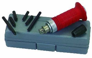

    There has been a hand full that were difficult try a free loaner impact driver from autozone

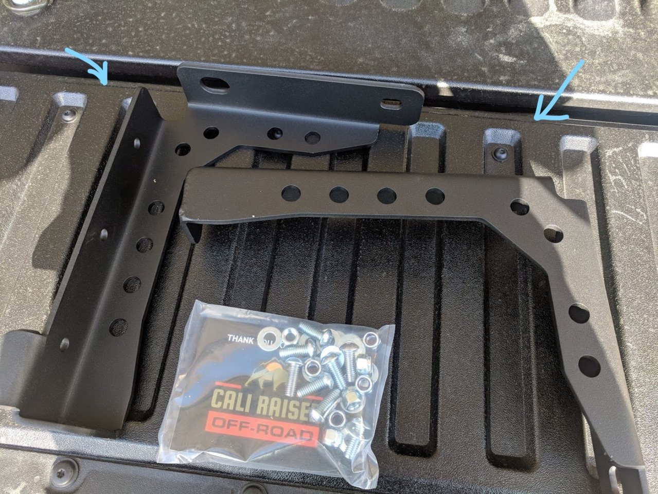

    Got It! - Cleaned Up Nice - :D
    Ready For Paint...
