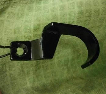

    It's Painted - Installing In 48 Hours -:locked:

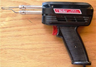

    Jeez...
    Seems Like Lots Of Trouble Getting That Screw Out
    I Don't See Any Thread Lock (Red Or Blue) In The Pictures Here
    But I'm Gonna Heat It With A Soldiering Gun - Just In Case
    Hold It On The Screw Head For 1 To 2 Minutes - Then :muscleflexing:

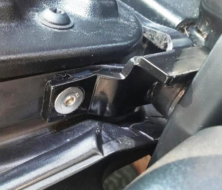

    SUCCESS!!! - Took 1 Hour - :thumbsup:
    Norsemanvike likes this.
  17. Jun 30, 2019 at 6:41 AM
    #157
    lennyk
    lennyk Well-Known Member
    Jan 10, 2014
    #120350
    107
    Mountain Top, PA
    Magnetic Gray Metallic
    My Procedure - Heat 1 Minute - Hammer Impact 6 Times - Breaker Bar - Screw Out
    Then Installed Bracket With Stainless Flat Head Allen M8 - 1.25 x 30mm - Torque 13'#
