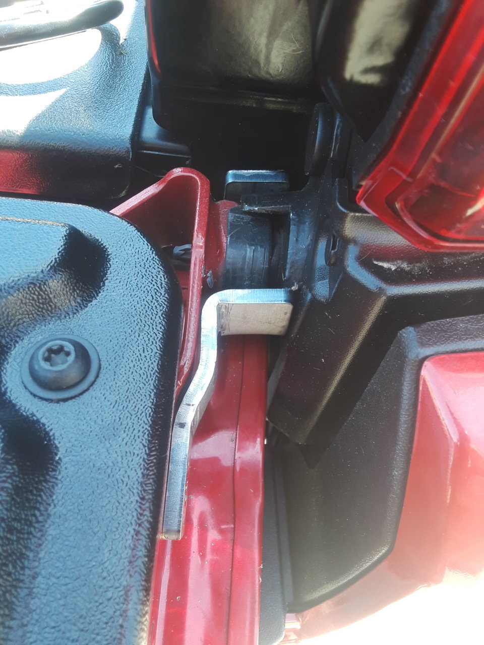

    All,
    A local San Diego mechanic here on the forum who owns his own shop helped get my torque bolt off. FYI, Toyota uses a proprietary version of lock tight which is stronger and requires 220 degrees of heat to liquify it... It cost me a six pack of Modelo to get it off - ha ha ha
    Anyway, once past that issue, I ran into another issue because the gap for the bracket was too small which prevented the bracket from going in. @christian06 suggested that it might be some sort of flexible sealer. Sure enough, I was able to use a long flat head screwdriver to cut just enough off to allow the bracket to slide into place. Keep that in mind if the bracket won’t wiggle in.
    I’ll need to put some sort of weather sealer back on to cover the exposed spot from glob I removed and figure out a way to make the new bolt more annoying to remove. For now though, here are my install photos.
