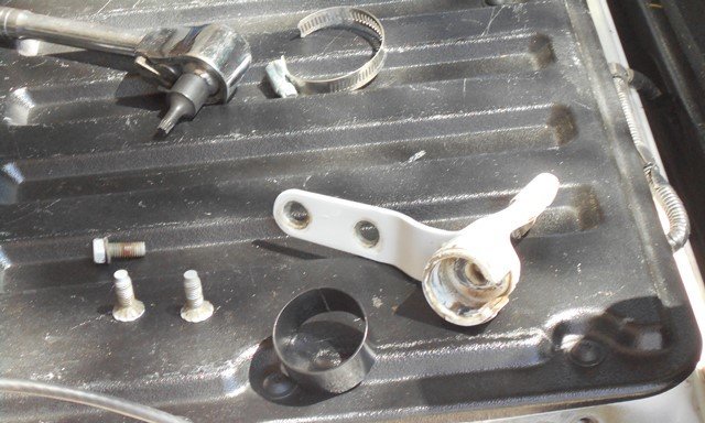

    Hose clamp goes away quick with a cold chisel - my grandson could figure it out. He likes to hit sh!t.
    This part below is available at O-Reilly's for a couple of bucks. Saw to a length that matches the hinge, makes a steel ring and screw it back on the tailgate.
    If they take the hinge apart - you still can't beat them. Fill torx screw holes with JB weld

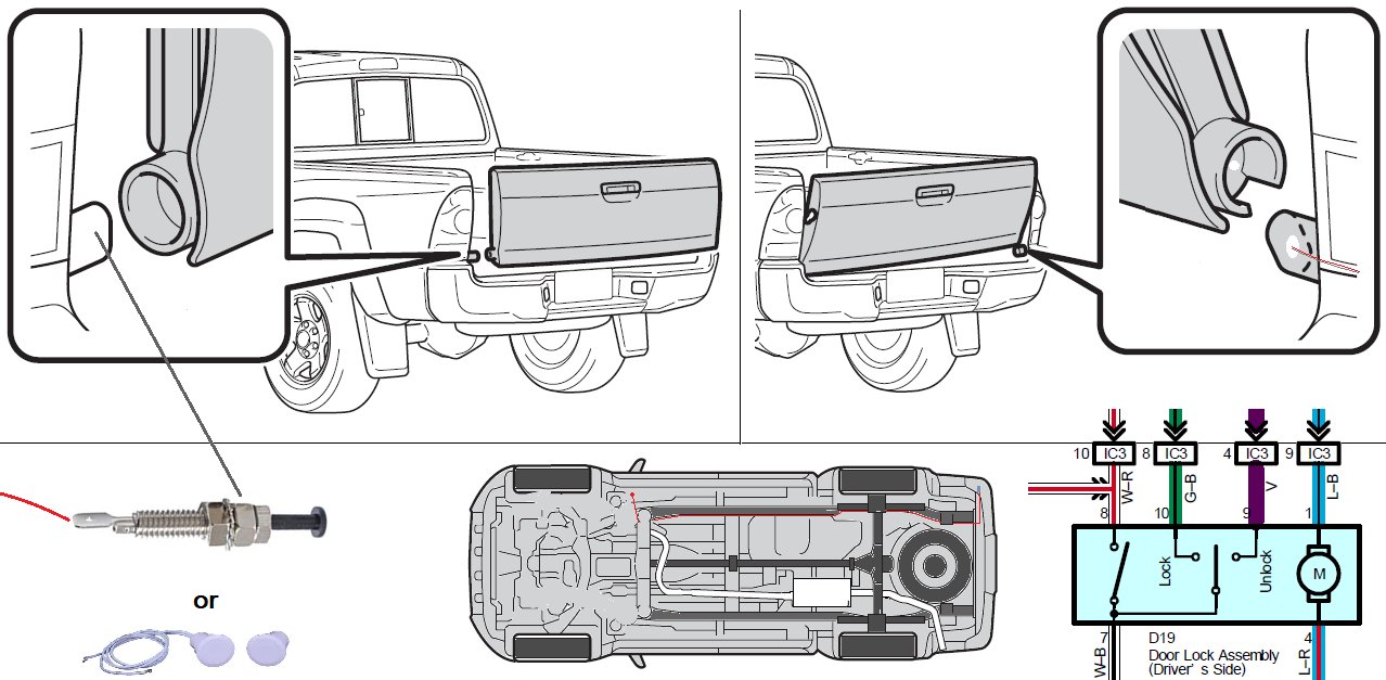

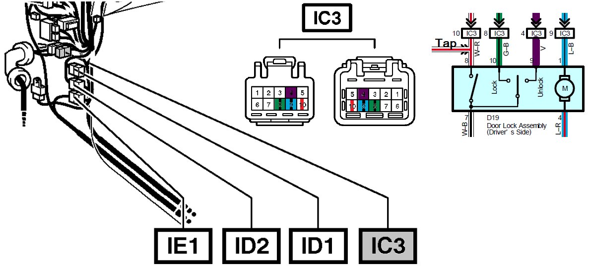

    How about adding this:
    Pin switch or sealed magnetic switch tied to the door lock sensor circuit.(Driver's side)

    So the alarm goes off. By the time you hear it your wiring is cut and your tail gate is GONE! :facepalm:

    So YOU prefer a silent theft...:rofl:. If you read again it's to be added with any other method.
    Step next would be to chain the tailgate with that padlock.
