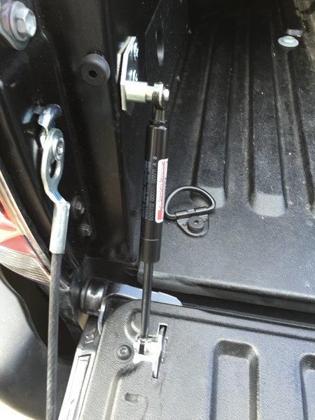

    image.jpg Well it's done and it works great now I can use the original cable with no problems . Nice to finally have the tailgate assist working

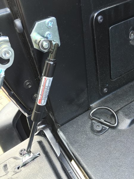

    Codeseven the design worked out great thanks

    Oh that's super awesome!!!!!!!!! Congrats on a job well done! I'll have a beer for you!

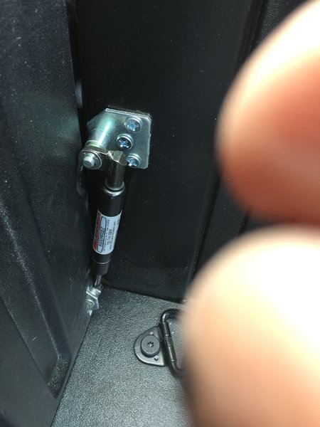

    But I just remembered, you put the mounts IN the tail gate cover. You want to seal them with silicone so water doesn't get in and rust from the inside. Find a good black silicon or caulk to seal up those open spaces.

    Codeseven with my tailgate shut and having the oem try fold cover its pretty dry in there so I don't think that it'll be a problem,plus with having a tailgate power lock I want to be able to take the tailgate cover off without having to swear to get it off lol

    I thought about it for a while and every time I wash my truck I also do the bed,so black silicone I did. Thanks for sticking that in my head

    Well I did it and it works but the steel from the bed moves a little when the tailgate start opening so I am gonna place a piece of quarter inch steel behind the bed steel to stiffen it up, I'll let ever one know how it works and I will take pics as I do it
