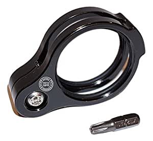

    Wondering if you have an option to have the full kit work with an antitheft device - would love to get and install your kit, but will not get rid of my antitheft ring.
    Cheers.

    Your ring should work, as the part it goes around is the factory oem part. As long as it fits a third gen tacoma, it will work.

    So if this ring works with a third gen taco, it should work on my second gen? I' not sure it would work.
    Here is the 2016+ Tacoma tailgate antitheft device from the same manufacturer...
    https://sabellco.com/store/index.php?route=product/product&path=33&product_id=68
    Will the dampener from your kit fit the 2016+ Tacoma tailgate antitheft device? I wonder if all I have to do is after installing your kit replace my second gen sabellco antitheft ring for the one on the link above for the 2016+ Taco??

    You can always install the kit and if your theft deterrent ring doesn't work you can install a hose clamp at least. Not as good as the ring you have but better than nothing

    The theft device ring will work since the part it goes around is a 3rd gen OEM part.
    If for some reason it does not fit, I offer a full refund policy, and also cover shipping it back.

    Isn't the bolt spacing different between 2nd and 3rd?

    One hole is there, the lower hole has a divot where it would have been, drill out that one.
    They line up perfect.
