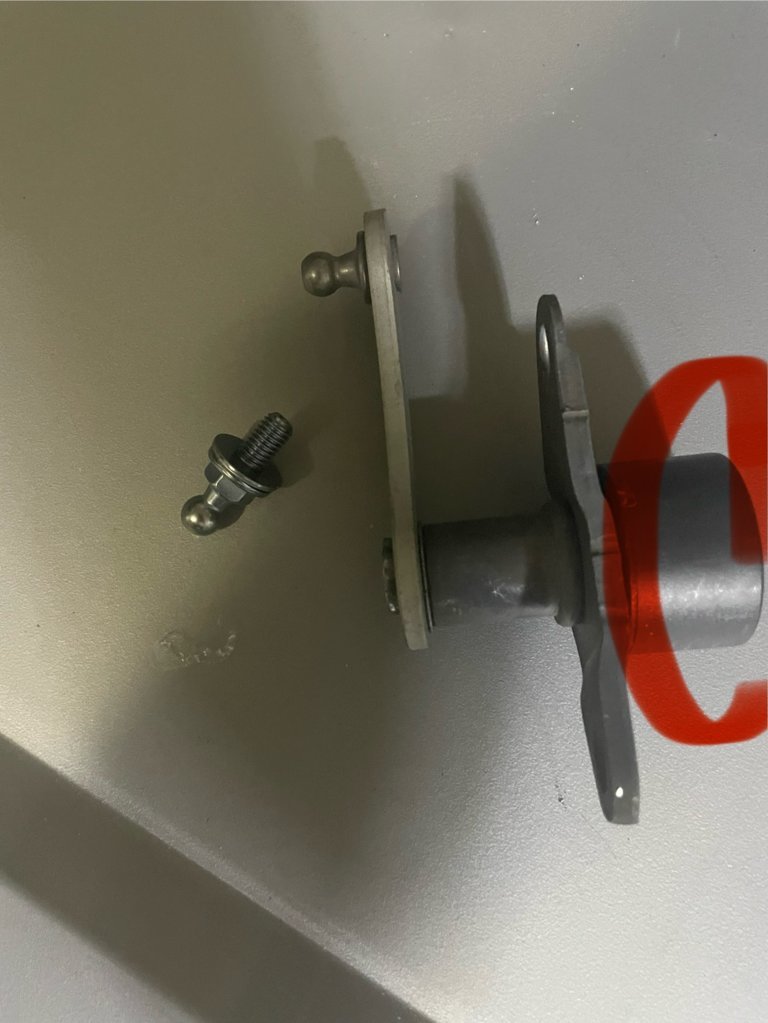

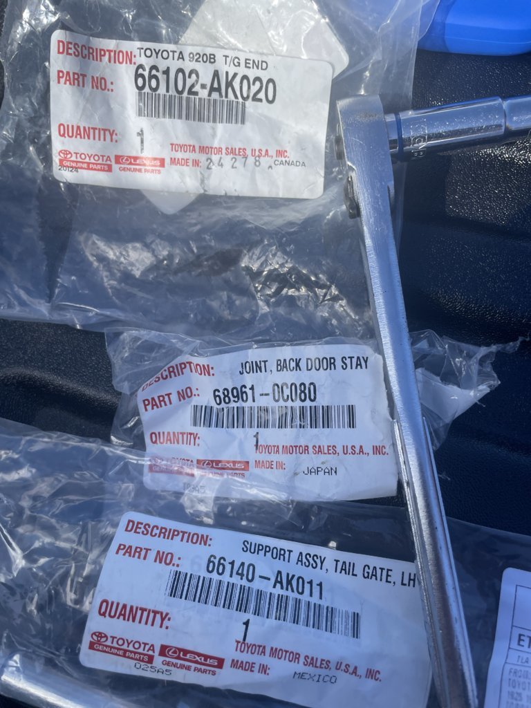

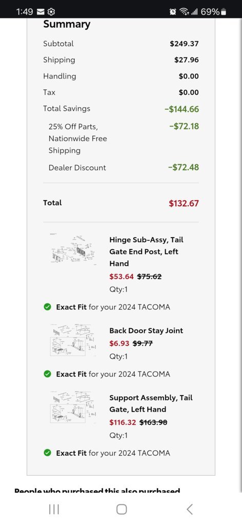

    I did it a couple weeks ago . You need 3 parts. All in about $160 if you order online and p/u parts. Took about 20 minutes w/ some help . I didn’t disconnect the tailgate wires . Laid 1/2 on the bed and had the wife hold up the other. Put the new hinge on first then put tailgate back one. Then removed light and put together rest of parts.

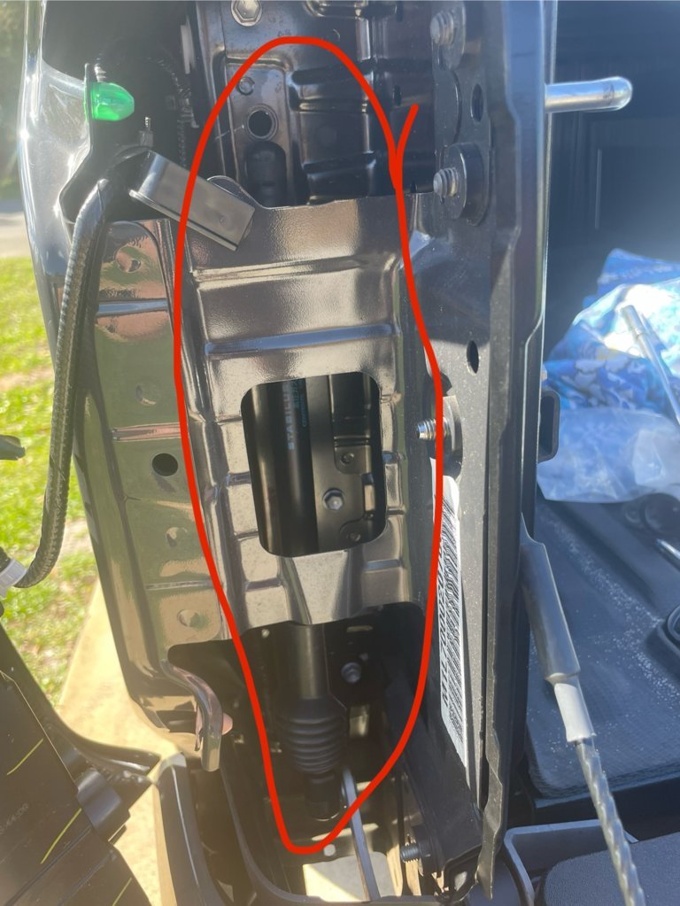

    I just wung it. I started to remove wires to the gate but opted not to when it gave me a hard time. Thats when I called in the wife to hold it . The hardest part was putting the gate back on. After you mount the hinge turn this round part to the correct angle to slide the gate back on then slide the right side on. Removal of gate is the same as 3rd gen and there a few videos online . After gates on remove taillight screw in ball joint in the threaded hole up top and slap on the support/shock. I fed support up from bottom of truck. The end of support w/ boot goes on bottom.

    Hard to see but here is the support connected to the top joint and lower hinge .

    Thank you to Mik8881001. These were the exact parts needed and everything was super simple to put together. Took me about 15 minutes.
