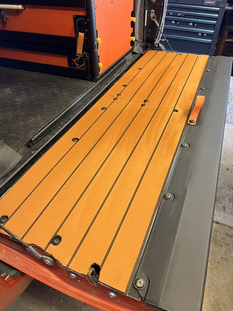

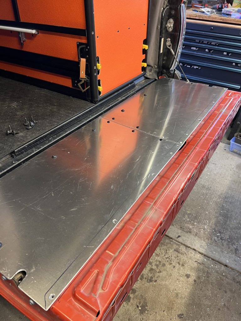

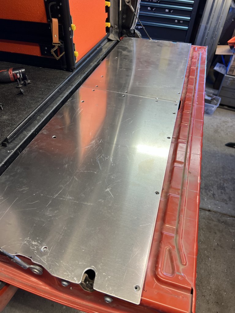

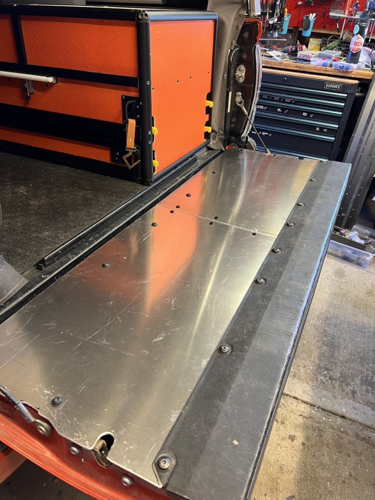

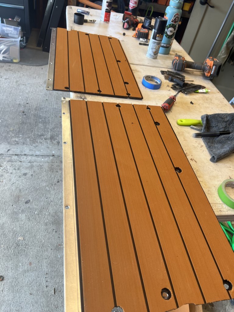

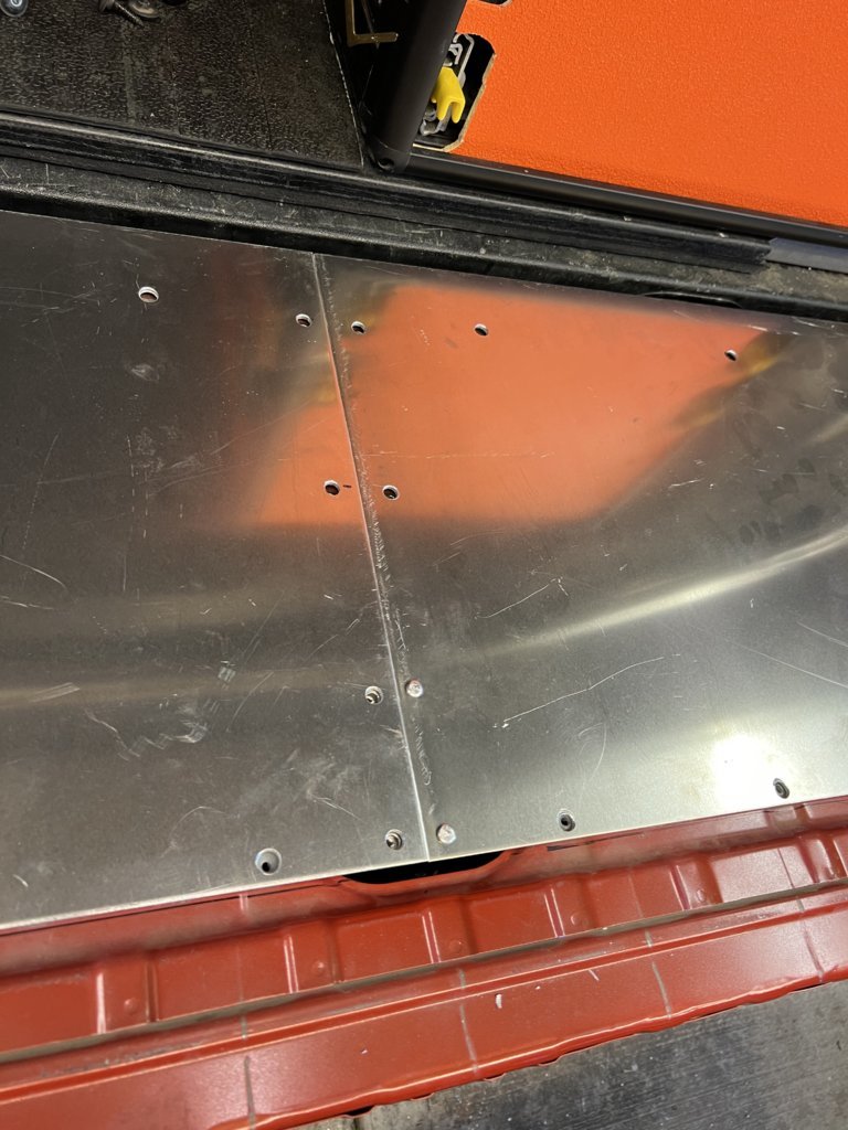

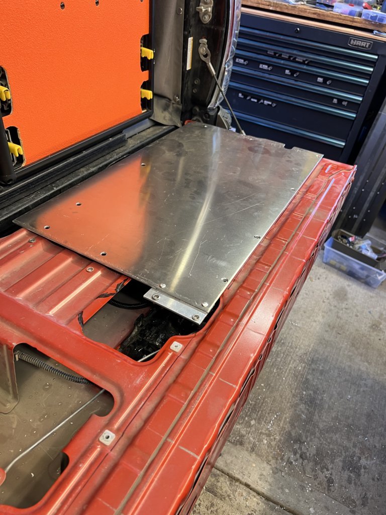

    Here is my version of a DYI tailgate panel. I installed an aftermarket tailgate electric tailgate lock that failed and was suck locked. I could not get the OEM tailgate panel off because my camp kitchen is in the way. I had to use a hole saw to get to the lock. After doing research for an aftermarket replacement the price was anywhere 125$ to 300$+ for plastic and aluminum options + shipping. I figured I could make one myself. One thing I wanted to do is split the panel in half, so I won't run into the same issue if the replacement lock fails.
    Materials:

    Very cool! Nice pix, thanks for sharing! How do you like that boat flooring? I think I've seen people use that and the carpeting on their bambeds

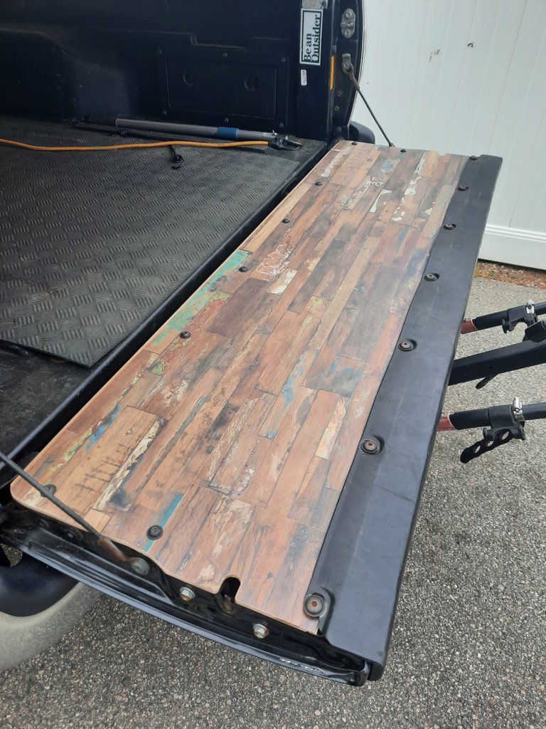

    I used some left over laminate flooring, just glued the pieces together and sealed the edges

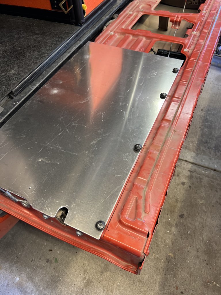

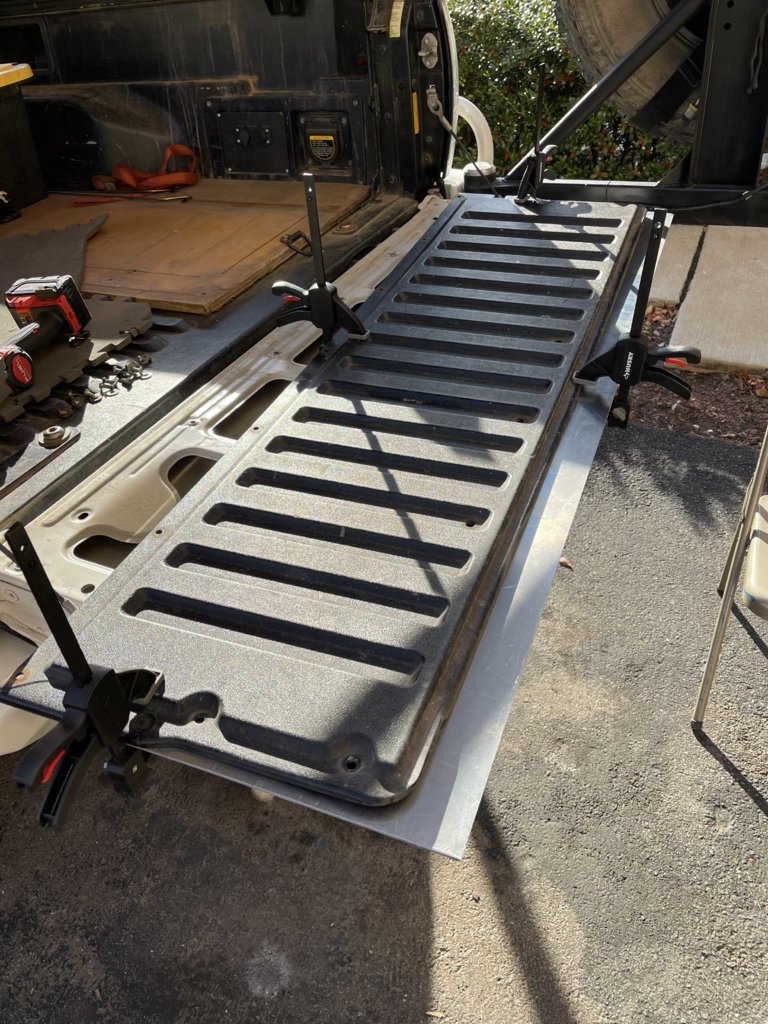

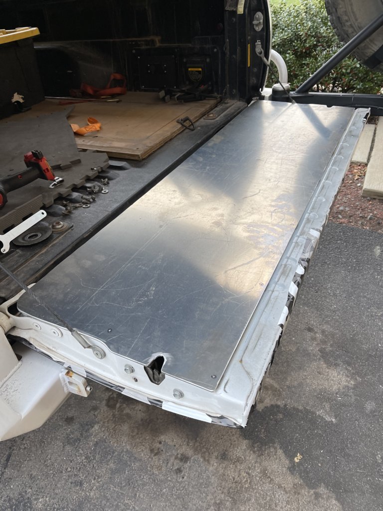

    Here's my 1/8" 6061 Aluminum tailgate panel
    clamp the stock panel to trace for shape

    that’s gorgeous, nicely done!

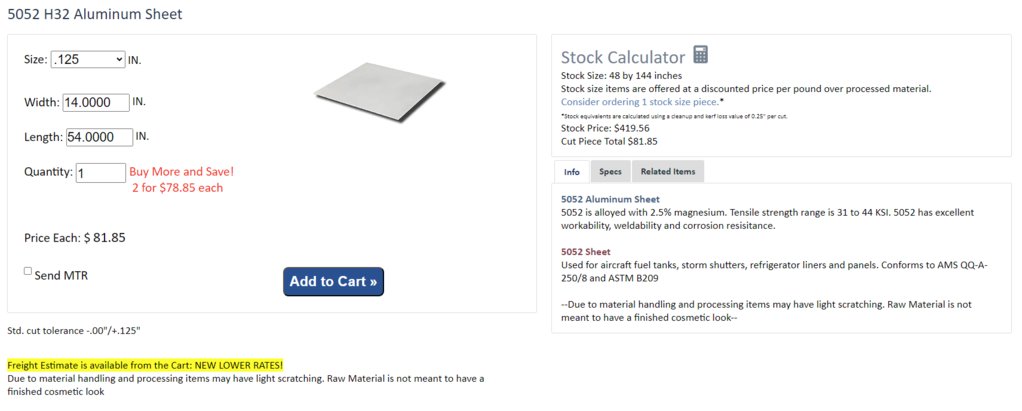

    Before shipping: 6061 .125 aluminum sheet pricing -
    one full sheet 48" x 144" is $440. A single cut piece to approximate dimensions of tailgate is $700

    Oh don't get a full sheet. I got 2 custom cut pieces. But maybe try a lower grade aluminum? Are you really going to know the difference?

    Use 5052. Also will probably be cheaper if you find a local place. At least near me they will shear it for a cut charge and you dont need to buy a whole sheet
