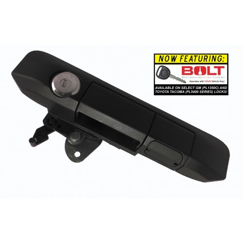

    got the OEM handle w/camera on my 08. love it whenever reverse parking or backing out.
    I'm going all out on the tailgate lock. So I ordered this from Pop and Lock, PL8540. It's their brand new combo kit that's about to be release. Comes with the PL5400 with a codeable bolt lock so you could use your ignition key. And comes with also power lock.
    http://www.popandlock.net/Power_Tailgate_Lock/Power_Toyota_Tailgate_Lock/Power_Tacoma?product_id=155
    If you don't mind having the powerlock than I recommend the PL5400, which you can already order.

    Now you have me thinking about switching things up again. I'd really like the convenience of a power lock on the tailgate. And it would be great to be able to use the ignition key.
    Since the PL5400 doesn't have a camera cutout, what are your plans for a camera?
  13. Dec 25, 2013 at 10:33 PM
    adio
    adio Well-Known Member
    Sep 11, 2008
    #9165
    2,637
    HI
    2015 INFERNO TRD PRO
    The PL5400 does have a camera cut out. Works with or without a backup camera.

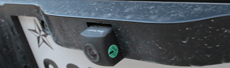

    I went with a license plate bracket backup camera by Alpine...
