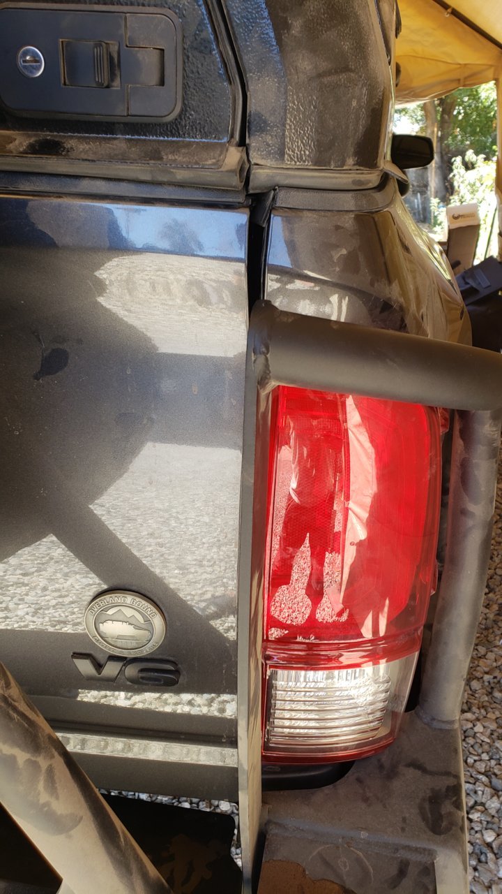

    Hey guys. Have done lots of searches on the matter. I have a camper shell and total chaos bed stiffeners on my 3rd gen taco but the gap keeps widening. It opened up quite a bit on my last offroad trip. Is there any way to fix this? I feel like the bed stiffeners have done nothing.

    Can’t tell what’s going on from that photo brother...be nice to see the gap along the vertical length of the tailgate both sides.

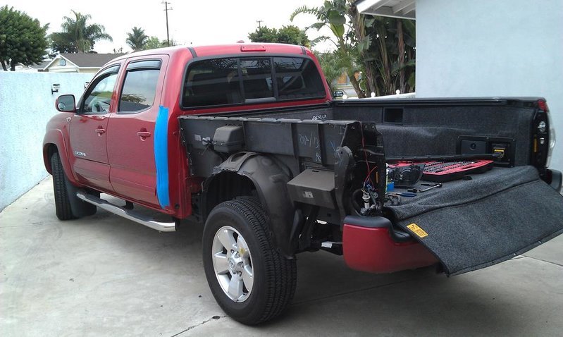

    Hmmmm. How much does that cap weigh?
    Was just looking at this picture, seems like there isn't as much support for that built into these beds:Tacoma side1.jpg

    Have you been rear ended? From here your right bedside looks like your truck took a hit . Seems like I see a buckle just behind the character line of the wheelhouse .

    No, haven't been rear ended. The rh panel fender is damaged from offroading but has nothing to do with the problem. Its been splitting before the fender was damaged. Just wondering if and how it can be fixed.

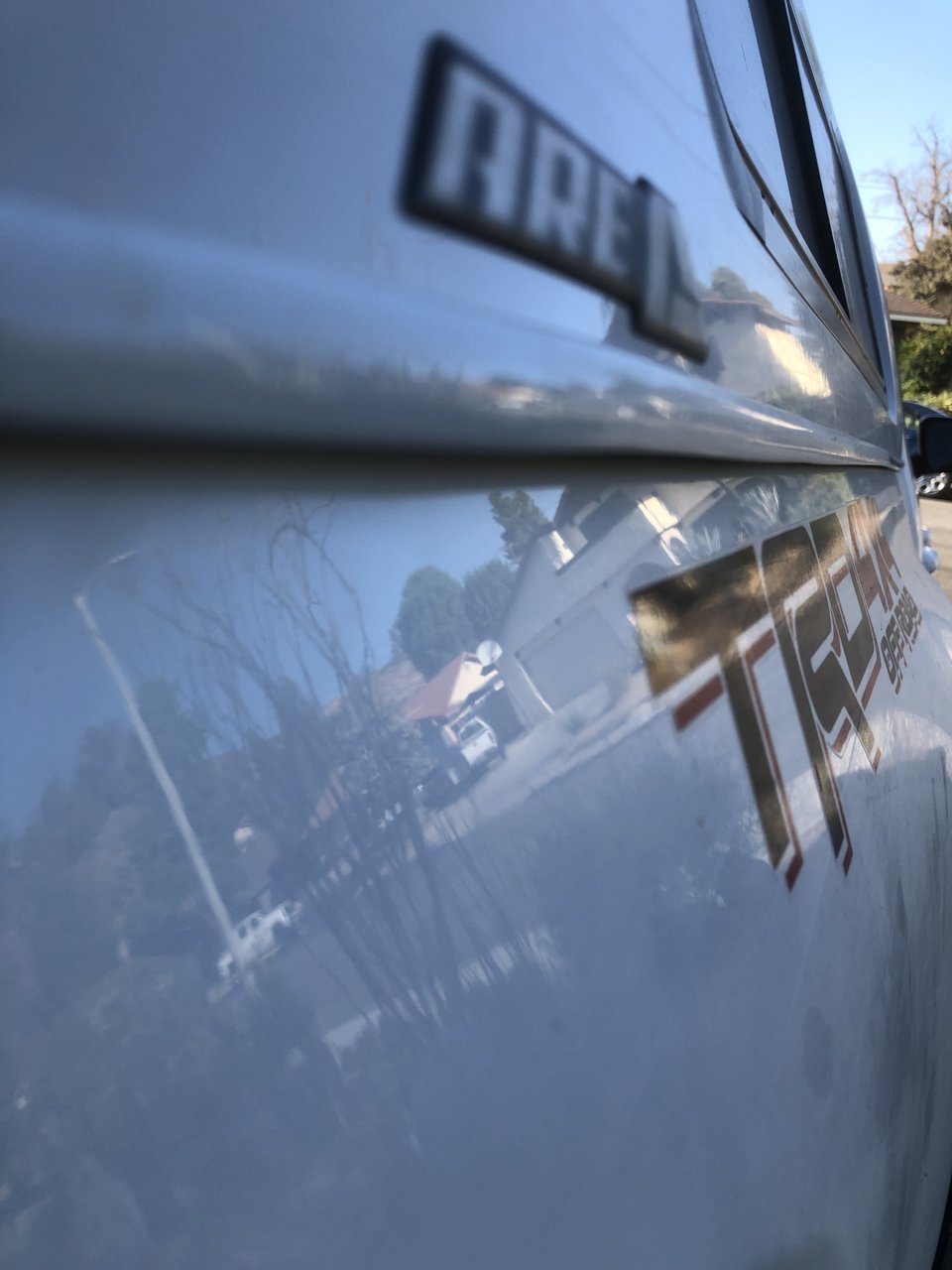

    @doubletap ‘s shell looks like its on top of the bedside rail so it does not support the bedside much, nor has much support from it. My ARE shell is very heavy too, plus has a rack, but it overlaps the rail and supports the bedside horizontally, as well as being firmly mounted to it by the front and very rear of the rail. There is no way the bedsides can bend outwards opposite of each other with it, but they can bend in the same direction if I park on a steep side hill.
    989CE9D3-FC39-49D6-AA86-662971681A7F.jpg Doubletap - were your bedsides ever under the lip of the shell and now they’ve slipped out?
