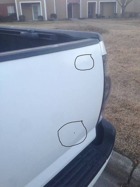

    While looking the other day, I noticed my tailgate was actually bending from the inside-out?
    I have no clue how this happened and it keeps showing up in more spaces.
    Kind of hard to see in the picture, but it's on the right side near the top and on the bottom where the tailgate bends in. Also starting to show up on the side by the taillight.
    Anyone seen this before or had this happen? I have no clue how it could be.

  2. Feb 20, 2015 at 4:25 PM
    File IFR
    File IFR "... Intercepting The Localizer"
    Mar 4, 2012
    #74145
    4,497
    Central MA
    2012 MGM 4X4 DC-LB TRD Sport
    You're carrying/loading something while the gate is down and putting pressure on the cup hinges.... this pushes the gate down and when you close the gate, the door is now bumped out proud of the body/tail lights.
  3. Feb 20, 2015 at 4:26 PM
    TnShooter
    TnShooter The TacomaWorld Stray
    Sep 2, 2010
    #42625
    20,938
    Deogee
    07' TRD Off-Road, Auto
    STOCK
    It probably happened because you actually used your tail gate.
    The tail gate on these trucks are weak. I'm betting that if you open up the tail gate you'll see braces where The dents are.
    The inside flexed because it is plastic. And the outside dented.
    I have dents in my tail gate. I no longer worry about.
    As long as it opens and closes all is good.

  6. Feb 20, 2015 at 4:29 PM
    T4RFTMFW
    T4RFTMFW Well-Known Member
    Jul 23, 2014
    #134525
    69,788
    Pull the plastic panels off the bed side of the tailgate and see if those circled areas line up with the tailgate braces, I'd say if they do, then yes, something heavy flexed the tailgate enough to push those braces and then make a high spot on the tailgate skin.

  9. Feb 20, 2015 at 4:34 PM
    T4RFTMFW
    Jul 23, 2014
    #134525
    69,788
    Could have. The tailgate is extremely weak on that side (the working side). It is mostly unsupported, and for sure if you pushed enough weight on the braces that are glued from the support structure to the exterior tailgate skin (where your dents are), it would definitely be possible for them to do similar damage.

  11. Feb 20, 2015 at 4:37 PM
    T4RFTMFW
    Jul 23, 2014
    #134525
    69,788
    I just had my plastic pulled off to install the Relentless tailgate piece, I think there are 6 or 8 braces connecting the support structure to the tailgate skin (exterior), and they're fastened with some kind of adhesive, 2 or 3 of mine were no longer attached, like you'd see if you'd taken a razor blade and cut through the middle of the adhesive. The fasteners that attach the plastic pieces are threaded into plastic, and there is little support in the tailgate. The braces are maybe 3" wide at the contact point, so they can potentially put quite a bit of force on a pretty small area of sheet metal. How wide are your dents?
  12. Feb 20, 2015 at 4:39 PM
    Swank
    Swank [OP] Certified Mall Crawling Instructor
    Nov 12, 2012
    #90979
    8,443
    Steven
    Greenville NC
    SOLD/TOTALED
    I'll have to do that tomorrow and check it out. I'm not sure, they're both maybe 5-6"?

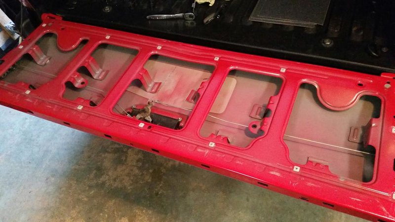

  16. Feb 20, 2015 at 5:30 PM
    #16
    T4RFTMFW
    Jul 23, 2014
    #134525
    69,788
    There you go, so you can see, if you sit on half of the tailgate, only 2 thin supports are really taking the bulk of the weight, and they're distributing most of it to the brace attached to the tailgate skin.

  18. Feb 20, 2015 at 5:33 PM
    #18
    oldracer
    oldracer Well-Known Member
    Jan 26, 2012
    #71492
    310
    Even standing on the tailgate (when it is down); can put enough force on those inside braces to potentially, crease the outer panel.
    When you get the inside plastic panel off; you will be amazed at the lack of support the tailgates have.
