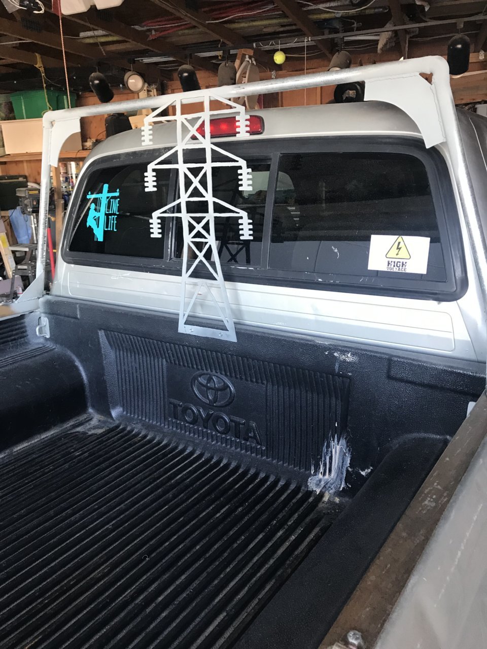

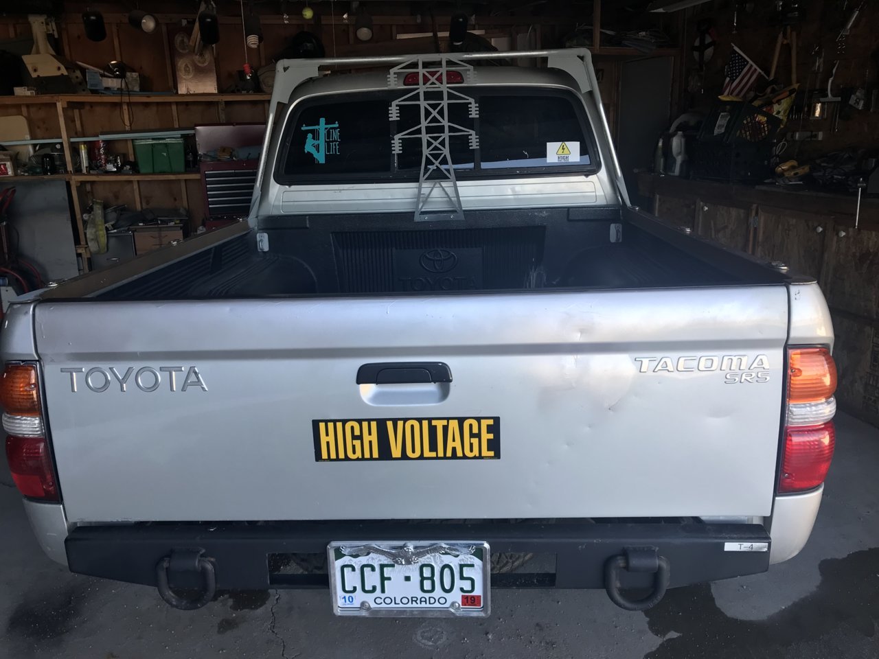

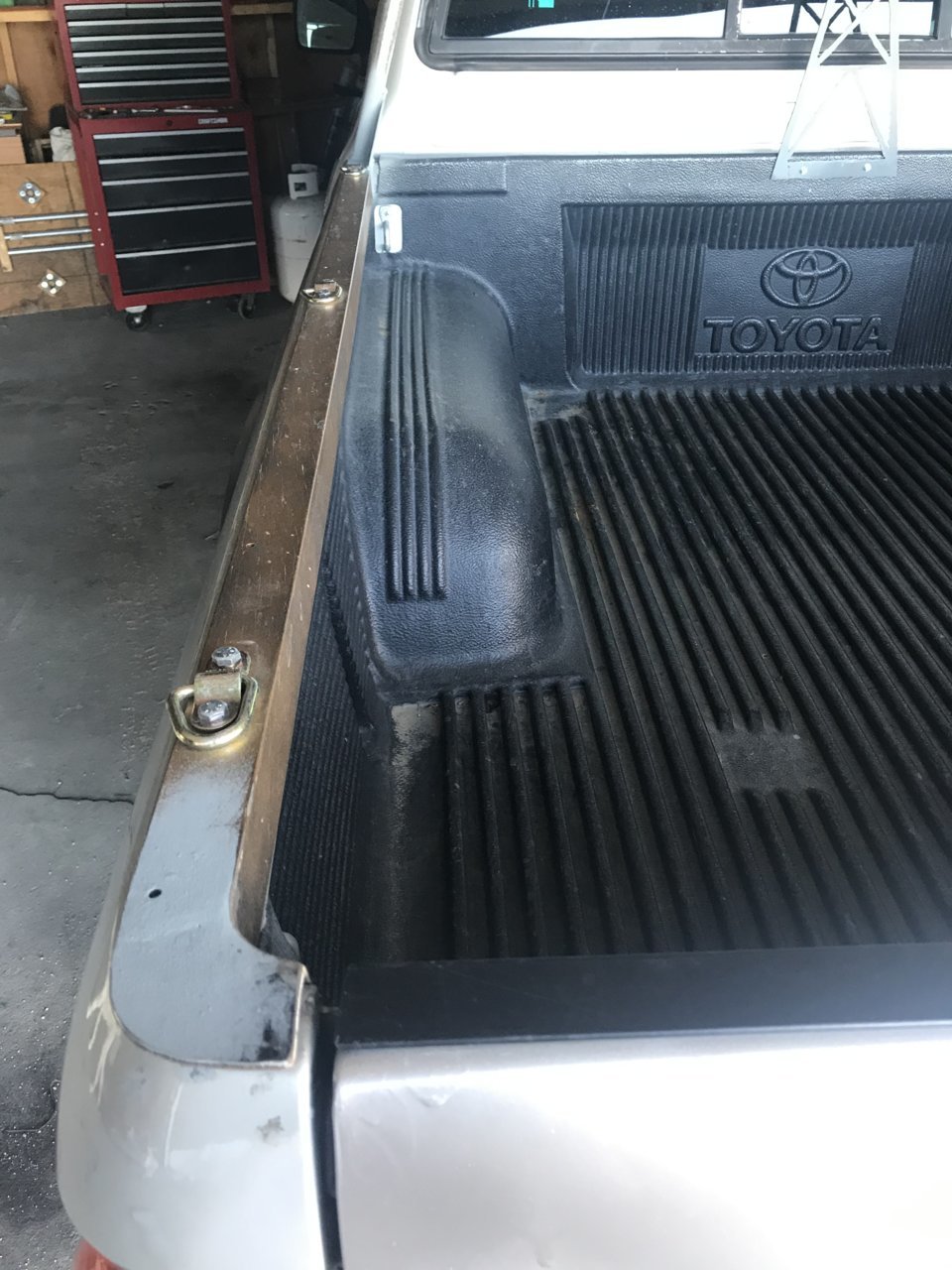

    I just built my wife side rails and rack on the back of her taco and across the tailgate (before it got bent)lol. I used bed rail. Bedrail angle iron is very strong. Bolted some eyes to it and used a metal strip underneath. In other words "right". Something you can tie to and not pull the bolts through the metal. Then on the tail gate just screwed it with several self taping screws. Not as strong but also not strapping things to it but for a motorcycle it will hold. The bed rail was perfect size for the top of the tailgate and the sides.

    I just built my wife side rails and rack on the back of her taco and across the tailgate (before it got bent)lol. I used bed rail. Bedrail angle iron is very strong. Bolted some eyes to it and used a metal strip underneath.In other words "right". Something you can tie to and not pull the bolts through the metal. Then on the tail gate just screwed it with several self
