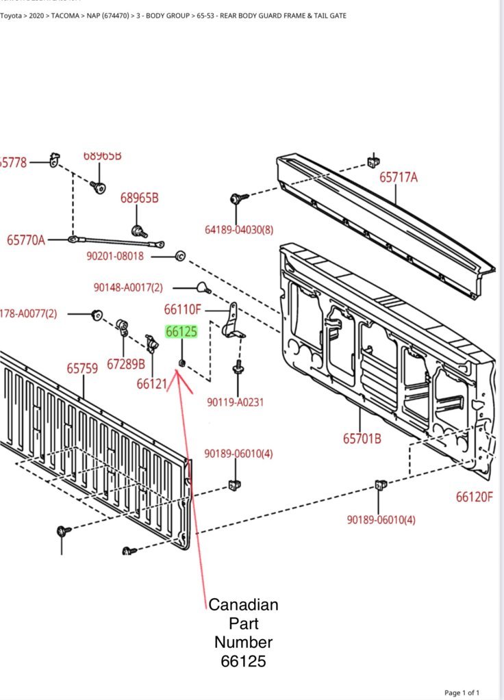

    The bushing broke on mine about a year ago. The tailgate popped out and damaged lower right side corner. At first the dealer was just going to replace the bushing under warranty but I complained and asked about the tailgate damage. They said collateral damage isn't coverage but Toyota Canada repaired the tailgate under warranty.

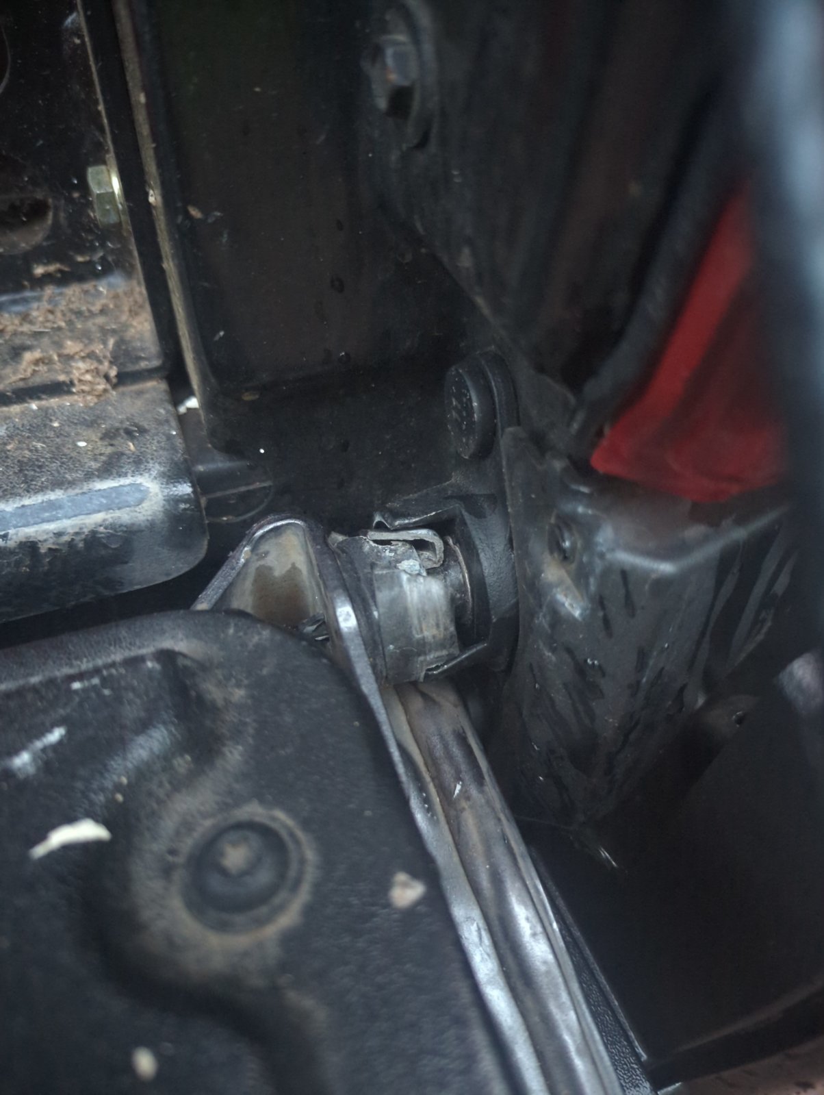

    Yup i knew what you meant mine looks exactly like yours unless we both have bent hinges i think its just the design maybe to help aid removal/reinstall of the gate. Its the crappy bushing i have replaced 3 since i got the truck new in 2021, toyota quality.

    Yea i’m wondering if it is bent because i looked at my dads 21 limited and it doesn’t appear to be bent like that. I do use my truck as a truck pretty often but still wouldn’t expect this a little over a year in.

    I'm experiencing the exact same issue with my 22. This will be the third time they have repaired it, each time they have to replace the hinge as well because it gets bent as soon as the plastic cracks and expands. Once it's expanded/bent/deformed the bushings wear more and more quickly. My dealer has a new fix that may include a metal bushing. I'm waiting on them to get back to me with a part description but there are a total of 4 parts being replaced and 2 need painting. I'm guessing it's both the pivot and the bracket on the tailgate. We will see how long that lasts....
    I think a more permanent fix will be cutting a pipe that fits over and around the pivot completely, then drilling and tapping a set screw. Making the gate more theft proof and beefing up that bottom pivot corner, which is the weak point.
