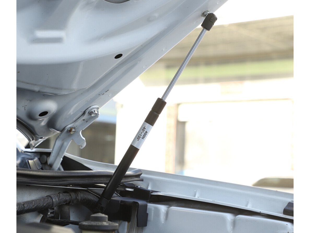

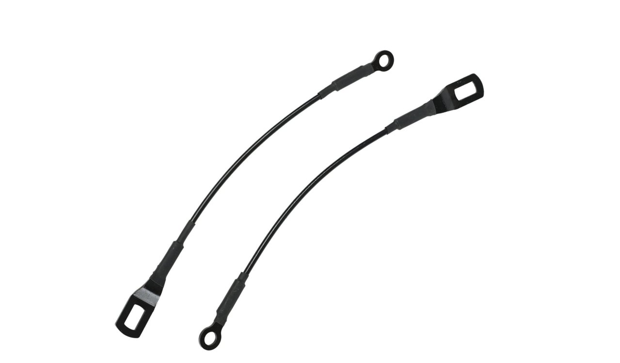

    i want tailgate open softly and plus it can hold sturdy the loads so im going to use the tailgate open if im be loading my honda monkey bike so i can get better support so in order to make this happen here is the picture what i want to do it so i want to replace the old strings onto these types of hydraulic tailgate assist

    OP, I've actually looked into this. well, at least until i removed my tailgate.
    They make kits for this but not for our trucks. You would not be able to replace the cables. The gas struts can't hold the weight of the tailgate, let alone any weight placed on it.
    however, if you can determine the length needed you can make a bracket to add the gas strut to the tailgate to give you the soft open feature you're looking for.
    I am unaware of anyone that has done this to our trucks though. Does anyone else know if someones successfully done this?

    A cable will be far stronger than a gas strut.
    To close the tailgate softly just requires some mindfulness on your part.
