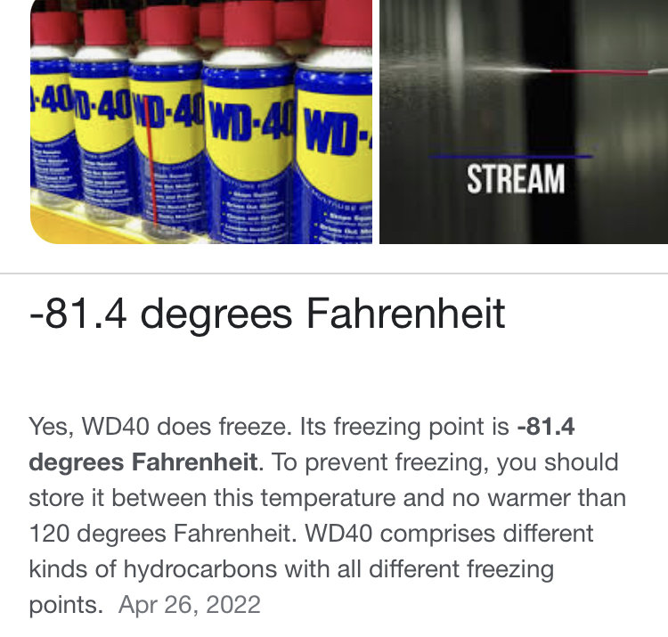

    Do not use WD-40 as it can freeze. Use something made for locks.

    *OEM Mods: Intermittent wipers, Fogs, Keyless Entry, Lomax
    I prefer white lithium grease and not WD-40 for hinges, locks graphite.
    You must live in Antartica if WD-40 freezes there …
