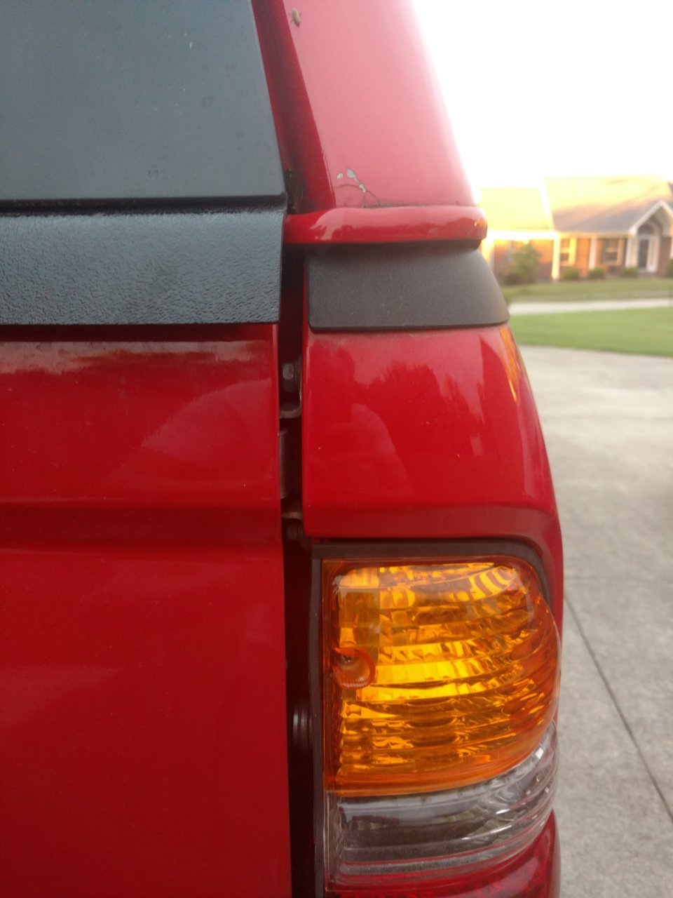

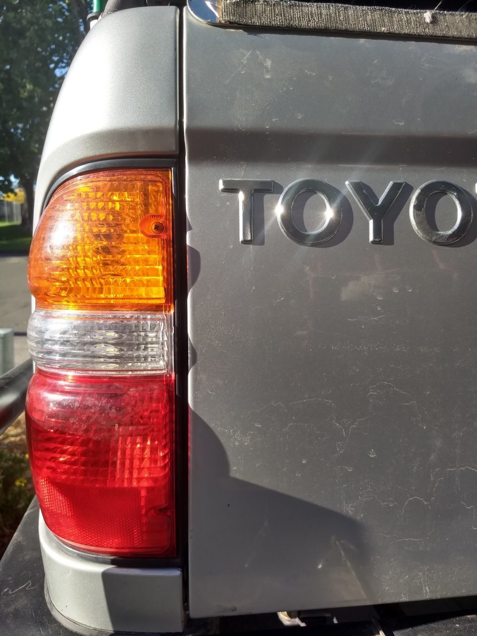

    I have noticed I have close to a 1/2 inch gap between my tailgate and my bed on both sides. This is causing a minor leak with my topper. Does anyone have any knowledge on why this is ? and what I can do to close or seal these gaps?

    Does the gap gain a taper from the bottom ^up? The other way around? Or is there a solid & even 1/2" gap on both sides?
    I had to add bed strengthers to the sides of my bed at the tailgate. They were splaying out. And I couldn't even close my tailgate.

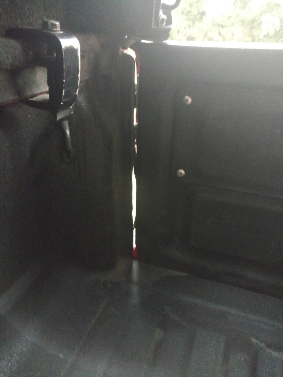

    They do taper out. I will get pics when I get off. What is this campers tape stuff? Would that rig it up for now ?

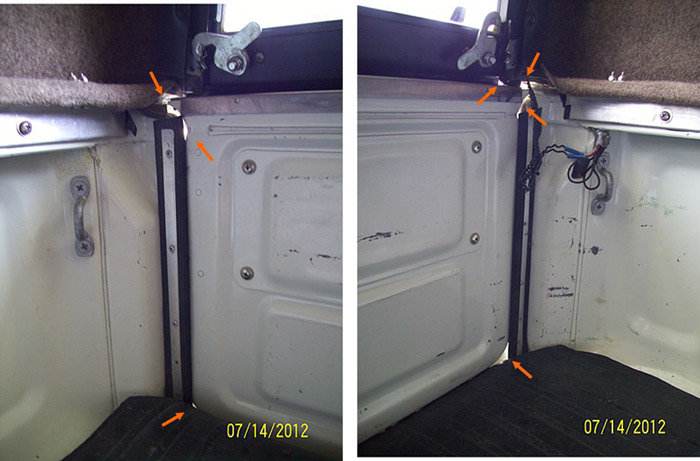

    I have lived with this problem since 1990 with each of my Toyota trucks, and have tried various means to seal it. I've used the 3/4" tape to seal where the bottom of the tailgate meets the truck bed, but that only lasted a few months, then the seal pretty much flattened out. I used the same stuff between the sides of the tailgate and the shell, but was never able to get a really good seal.
    Next, and with my 1998 Tacoma, I noticed some air holes that were punched into the sheet metal just underneath the bed rails, so I covered them with duct tape. For the next 3 years I noticed an unusual amount of dust was getting into the shell (I do a lot of off-road camping and travel dirt roads frequently). So I took the duct tape off and now I don't see nearly as much dust collect inside the shell.
    Early on I found some weatherstripping. Can't remember the name or manufacturer though. I cut some metal strips and mounted the rubber weatherstripping vertically along the inside rear of the bed, and used pop rivets to hold it on. The tailgate closes against the rubber weatherstripping.
    That has lasted since about 2000, but, if you look at the photo below, the red arrows show the parts that I couldn't properly seal. In any event, those leaks don't bother me and they do not leak water, just some dust. And not too much of that either.

    half an inch?! That seems way big for what's "normal". Where are you measuring? pics?
    Even for a typical gap, though, as has been said, pickup truck beds (by design) are NOT watertight.
    I think maybe the rubber seal for a pop-up tent trailer might fit in the gap btwn the body and tailgate. That might work.

    Yep that looked like mine.

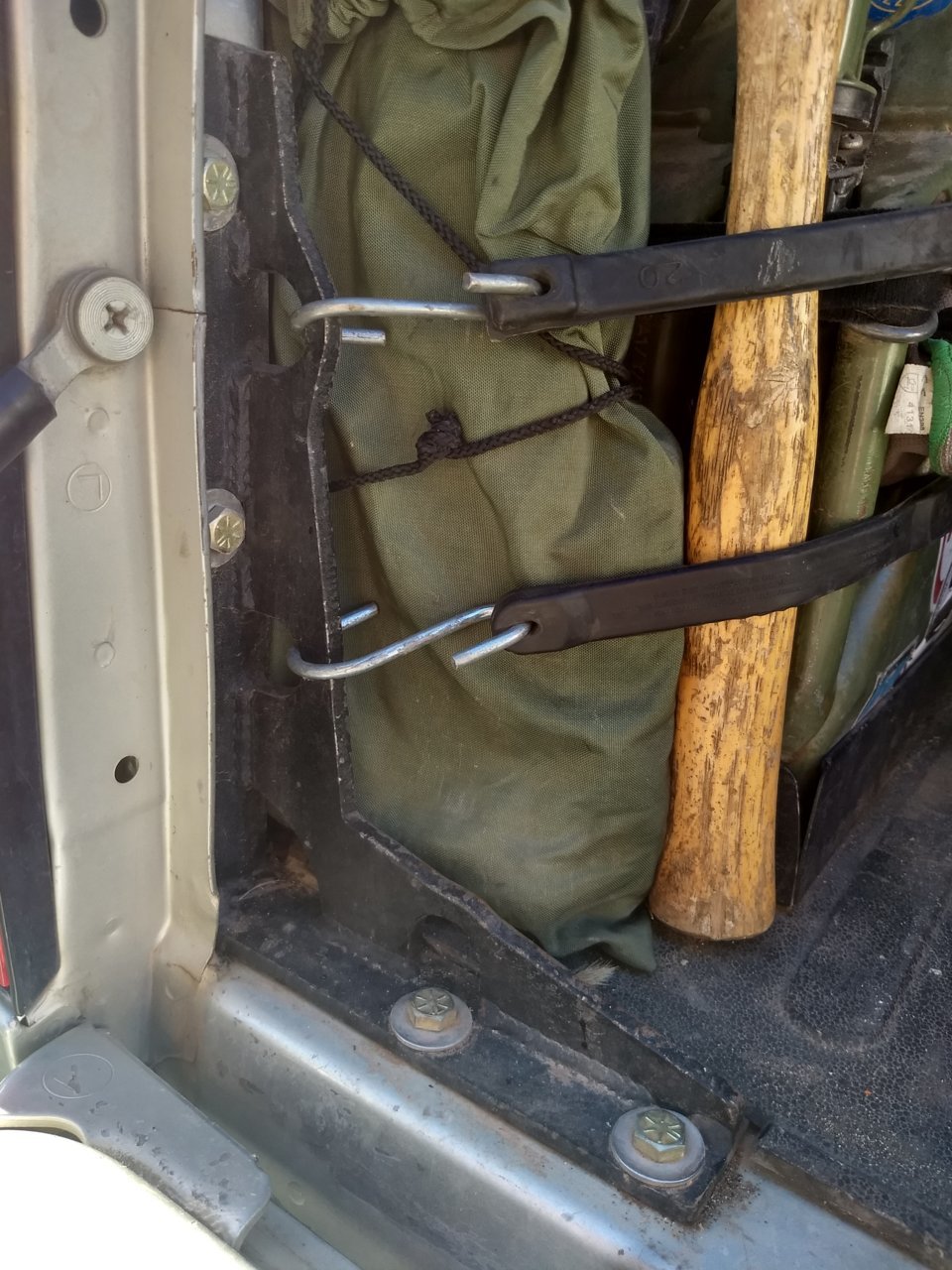

    I had a fabricator weld up some bed straighteners that fixed the problem. Nobody makes them for 1st gens from what I've found...
    Nice and straight now.

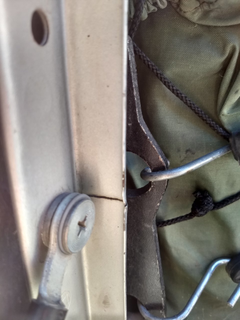

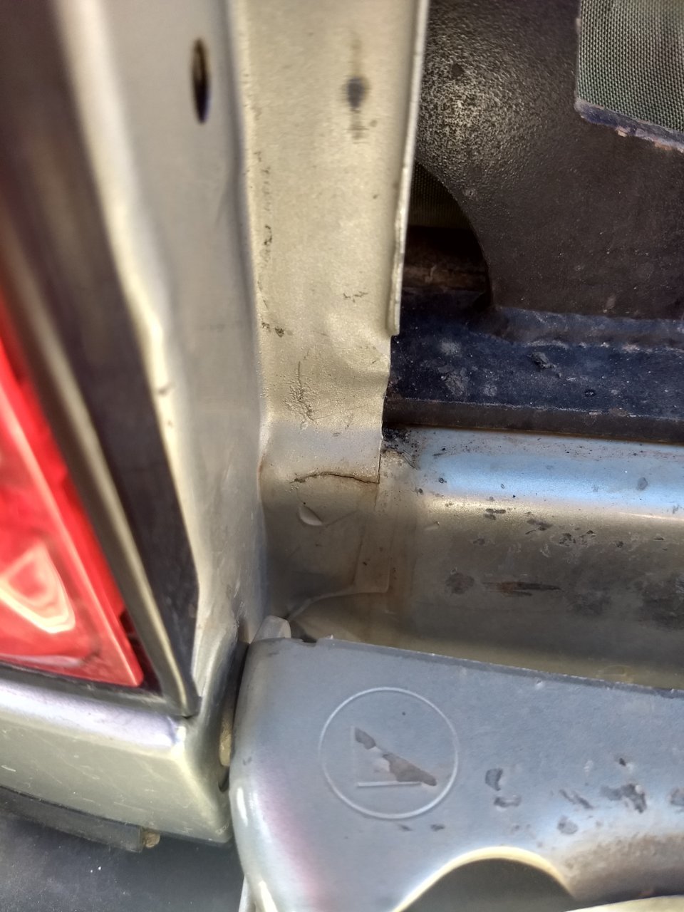

    You can see that my issue was causing the bed side sheet metal to crack.

    Yep just an L-bracket with a gusset.
    Yes I used a rachet strap to pull the bed sides together. Got them perfectly square. Marked my eight holes. And drilled. Bolted the strengtheners down with the strap keeping them straight..
    Did that 18 months ago and not an issue since. And I have a 250# worth of weight on the bed sides, an over softopper bedrack with an RTT bolted to that.
    I didn't add weather seal.

    Oh I forgot. I'd had to use a razor knife to cut out some of the body glue out of the corners, to have strengtheners sit perfectly flat.

    This is all can find online for 1st gen Tacoma bed stiffeners - - Pretty pricey (IMO) - disregard the URL title 2005-2015 as once you get to the page, 95-04 is an option.
    Here's a pic of my first RTT bed rack where a bed bar was incorporated to help prevent the sides from splaying out. Just visible in the picture just inside the tailgate. One side could be unbolted and the bed bar swung up and out of the way to load larger items in the bed. https://www.yotatech.com/forums/f172/rtt-meets-taco-183300/#&gid=1&pid=1
