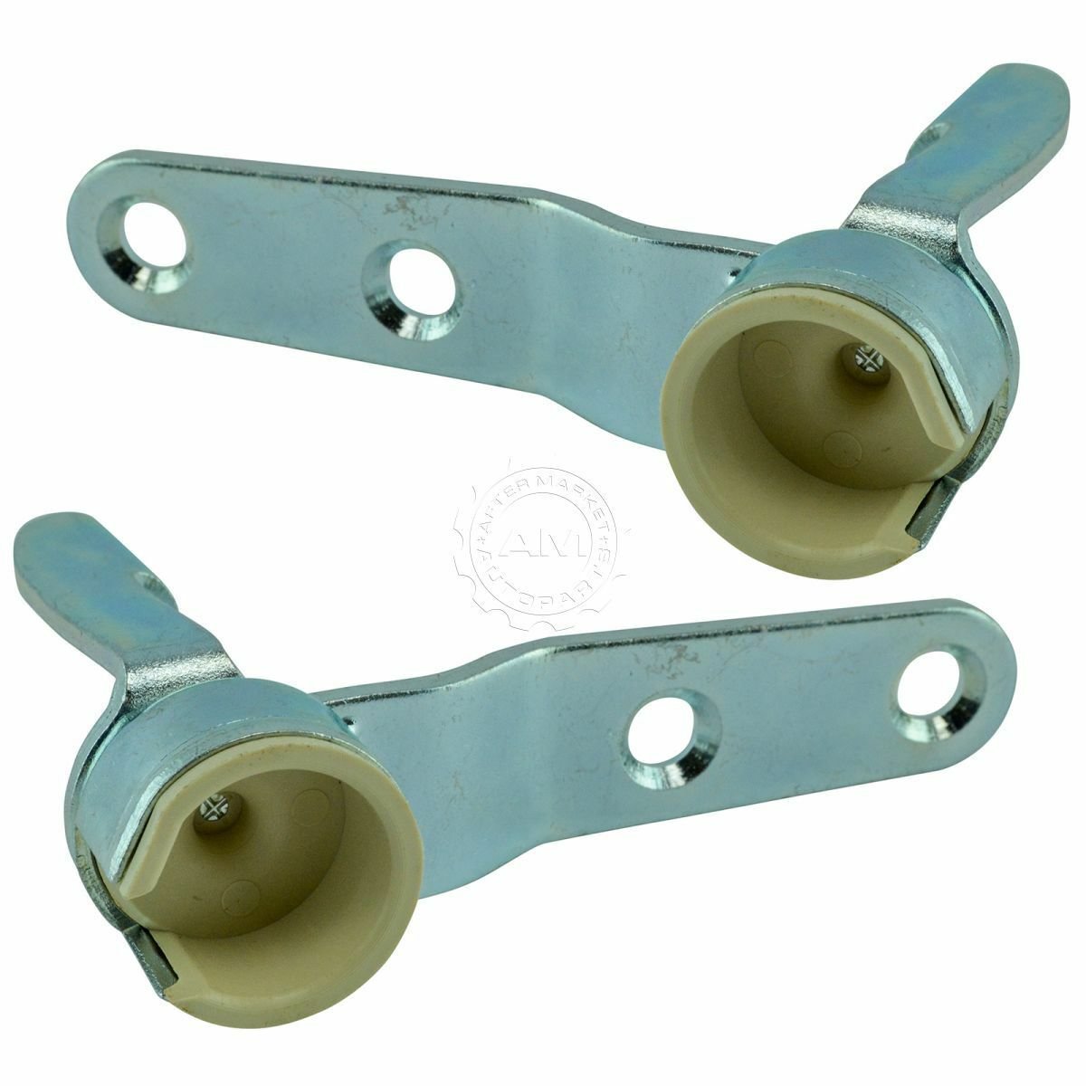

    There are supposed to be plastic bushings...
    My tailgate "hinges" were really worn out. Metal on metal with a lot of play.
    I found a new set of hinges with a plastic cup bushing on the inside. Night and day difference it how the tailgate now operates. Play reduced significantly.
    About $50 from Ebay for the pair.

    I think the bushings are riveted on... so probably not available solo.
