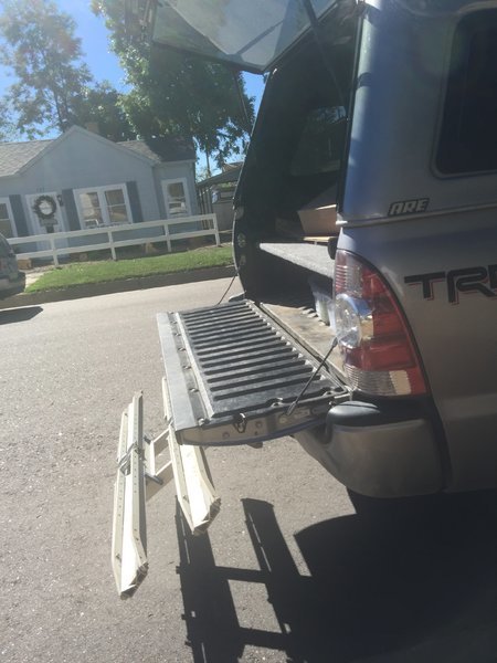

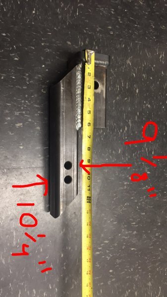

    Apologies on the formatting of the pic, but this should give you some idea.

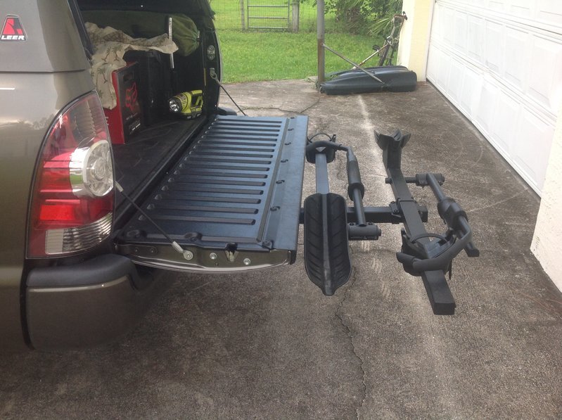

    This is my Thule T2. Works fine but I slide the trays back about 3/4" on the backbone. I'm not sure about other brands and whether your able to move them or not I'm happy with it. Even with the bike on and the rack tilted down I can open back to my camper. image.jpg

    We are finishing a new product which is a swing away hitch that could easily hold a 6-bike North Shore Rack or something similar. Will swing entirely away giving 100% access to the back. Stay tuned!

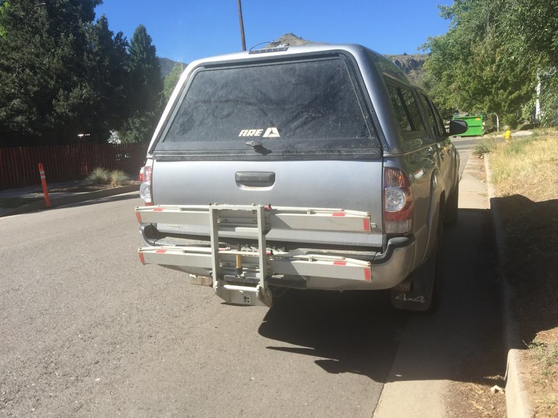

    I finally ordered a swing away extension that's been working really well. It's from Kool Hitch and cost $200 plus $30 shipping. It has dual receivers and I won't be towing with the bike rack on so I'm going to cut the towing receiver off of it. Now I just need to replace my 1 1/4" with a 2" bike rack so I don't have to use the wobbly adapter and I'll be set! Added bonus is that the Kool Hitch bumps my rack out away from the tailgate so even when it isn't extended I can open my tailgate and fit between my bikes and the truck. It's perfect for camping as I can swing the bikes well out of the way and access my sleeping platform in the bed and gear stowed underneath. I dig all these ideas! Thanks for all your input. I'll try to get some photos up so you can see how it looks. https://kool-hitch.myshopify.com/collections/kool-hitch-products/products/kool-hitch-swing-arm
