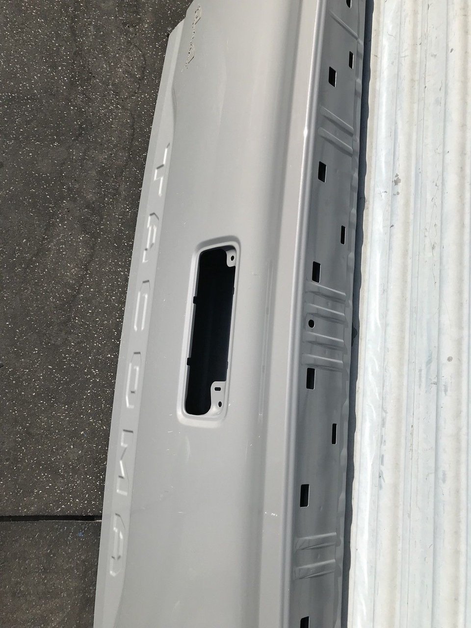

    I found this picture on a ebay ad. Looks like if you lift up the black plastic, there are holes that you may be able to stick a coar hanger in and catch on to the lock and possibly open it? Long shot but maybe worth a try...

    Also, if all else fails, you could drill out the handle where you can see the screw attachment points on the sheetmetal to remove it from the outside, That would definitely require replacing the outer handle though so that would be a last resort.

    Would be one of the last resorts since I'm pretty sure the camera and handle are one piece. Probably not cheap to replace.
