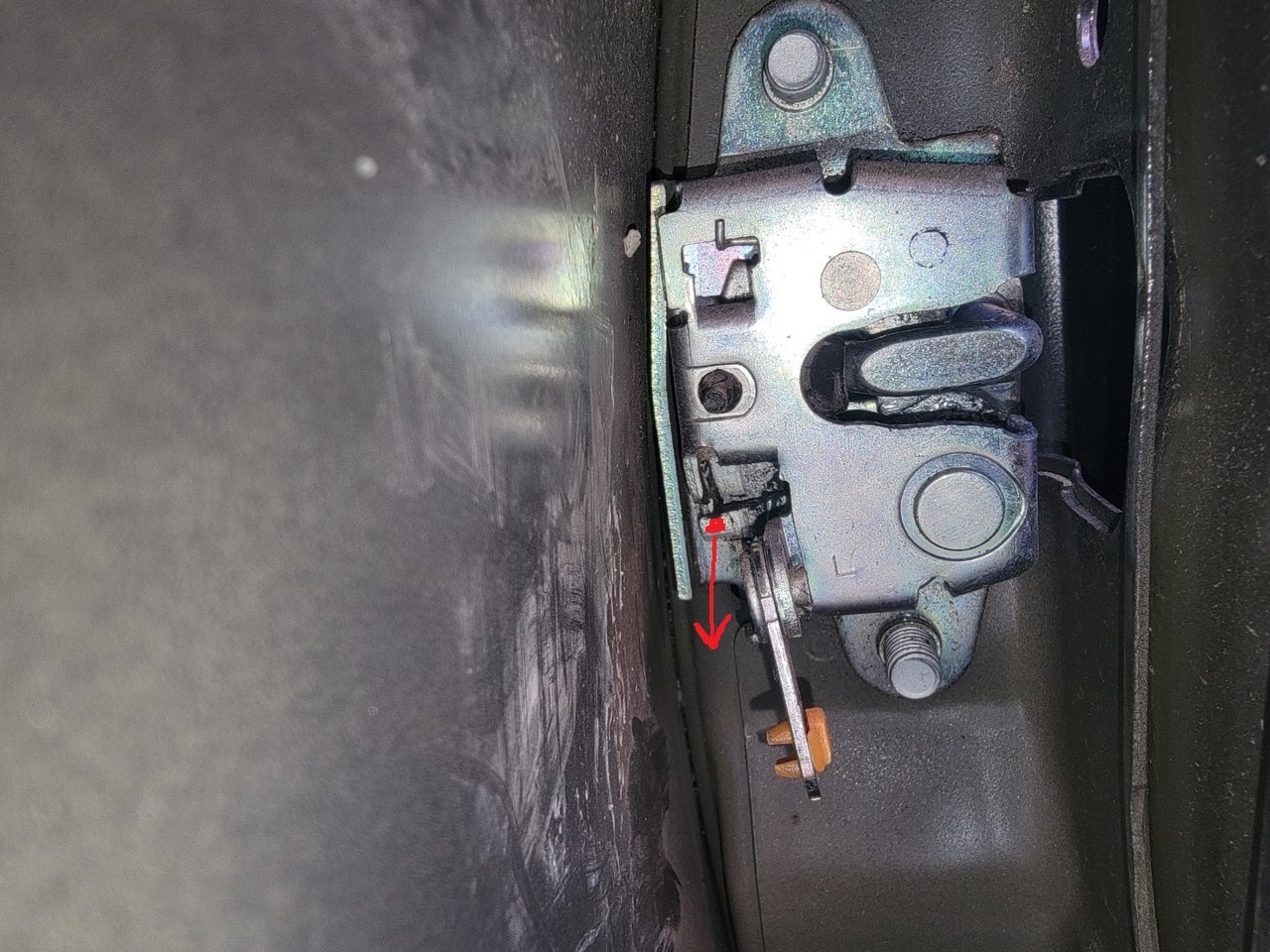

    Driver side internals busted, now the actual latch appears to be jammed underneath the D ring. Can't pry it either direction far enough to free it up and can't access the bolts while the gate is up. Suggestions?
    Edit - linkage is off i know, the part it is attached to inside the mechanism is broken so it was doing nothing.

    It looks like the linkage cam lever overrode the latch in your assembly, so it now it is on the wrong side of the latch.
    Unless something else is broken internally, you just need to push down on the secondary lever with a flathead screwdriver or pry bar. Here's what I mean:
    Here is a description of how I fixed this problem on my truck:
    https://www.tacomaworld.com/threads/mk5-adventures.567028/page-5#post-26015046
    In my opinion the latch mechanism isn't very well designed, it eventually gets pried apart, leading to this situation. It was suggested that pushing the tailgate forward to relieve pressure before opening the latch could preserve its life. But I am glad I welded mine together so they can't randomly get jammed any more.
