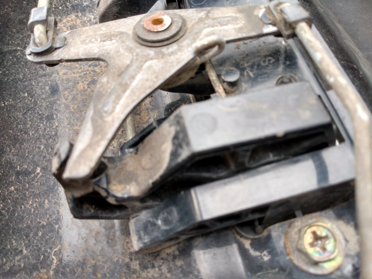

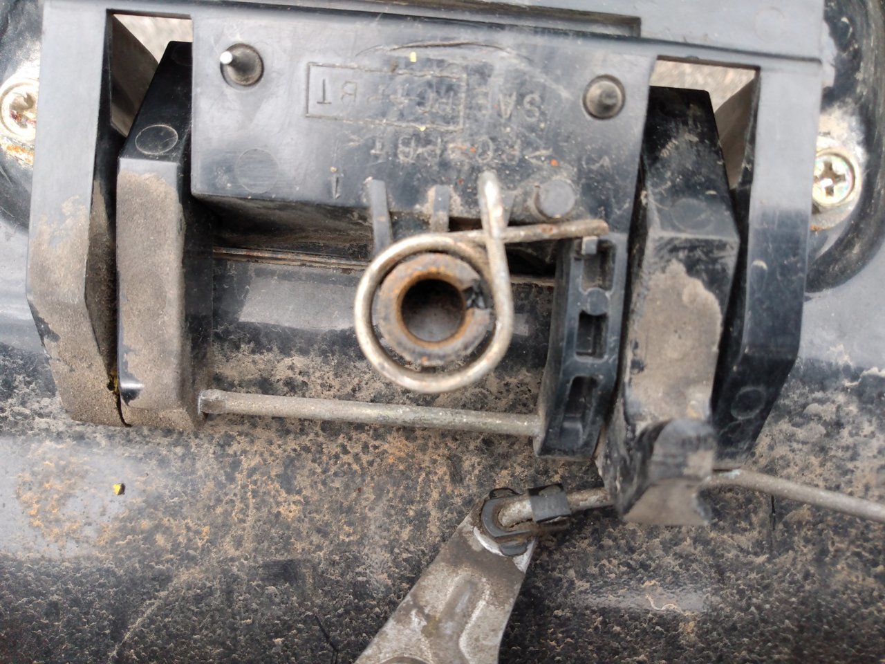

    It fell out. Is this how it goes back in?

    Thank you for the video. The handle on my tailgate is dorked. It still works but I wonder for how long. I do have one question: When it broke, how did you get the tailgate open? (Curious minds want to know :boink:)

    Unscrew sheet metal flap on the bed side of the tailgate. Pull on two control wires towards the center of the tailgate (towards handle). This undoes the two latches on the side.
