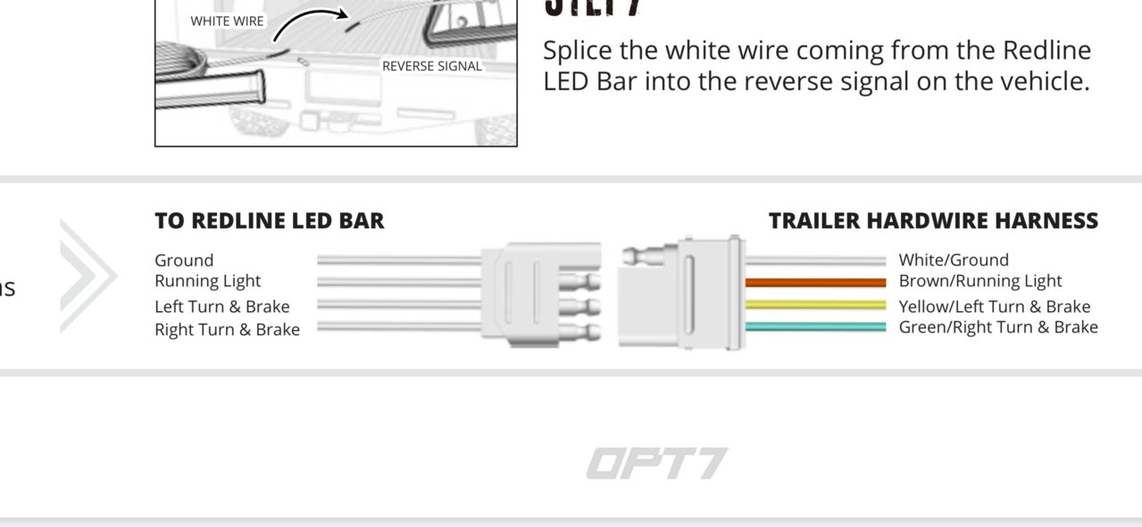

    Anybody install this one:
    https://www.amazon.com/MICTUNING-Ta...1599144606&sprefix=mic+tuning+tailgate&sr=8-4
    Someone with a 3rd Gen posted a video and it looks like it would fit and be two separate pieces so I could still access the spare tire hole.
    I also dont have a tow hitch so has anyone else hard wired their tailgate light bar directly to the tail lights?

    Has anyone hardwired their tailgate light bar directly to the taillights? The light bar uses a flat 4-wire trailer type connector with a reverse light wire. Our trucks wiring at the tail lights has separate wires for the turns and brake, but on the harness, it is combined. I cant figure out how to wire this. @caribe makaira would you happen to know how I would wire this? Thanks.

    4 wires, but one is a reverse tap...
    Does the light bar instructions mention a STOP feature besides the TURN and Tail?

    Here are the instructions that shows what wires to use on the lightbar.
    https://m.media-amazon.com/images/I/81yCVJ-p8zL.pdf
    its at the very bottom for hardwire.
    there is supposed to be a separate wire not attached to the trailer harness that i would connect to the reverse light. Not sure why that one isn't showing on the instructions.

    Post a pic.

    I took a screen shot of the wiring. It doesnt show the reverse but that is straight forward, its the brake/turn signals which I cant figure out. 5F313F1A-C396-4C7D-8731-EF3D430855D2.jpg
