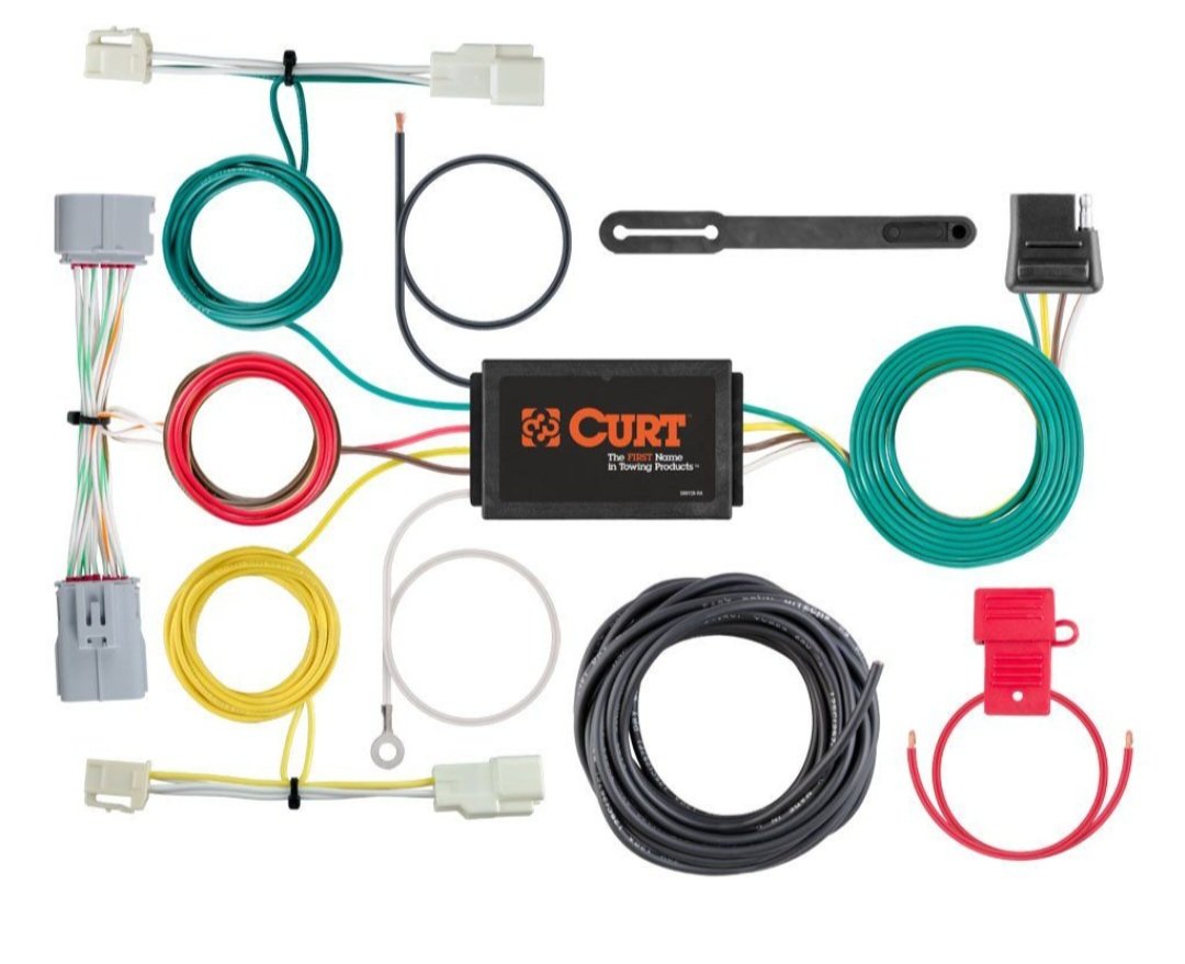

    Short from buying a Curt wiring harness, i was hoping for a solution that wouldnt cost me another $50. If thats my only option, then I will have to do it that way.

    Thanks! I will try to look around and see if that will work. Otherwise I may just purchase the Curt wiring harness since it is plug n play.

    Is this what you bought?

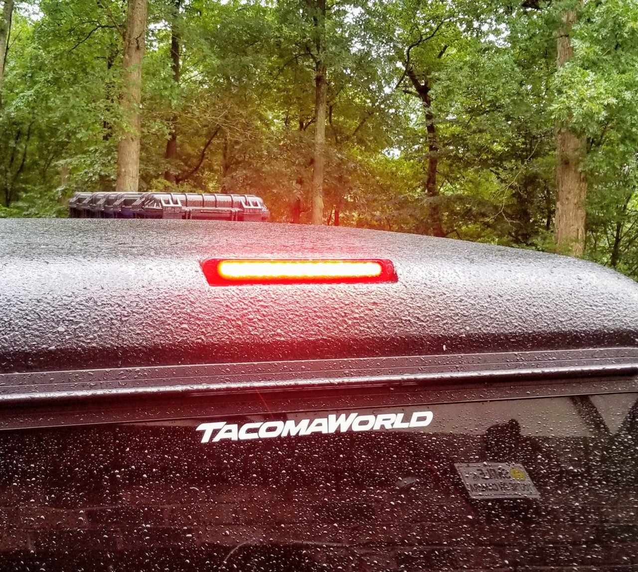

    Make sure you check your state laws. Maryland requires the center mounted third brake light be higher than the two side mounted brake lights. This disqualifies these tailgate light bars. You can save yourself some money and buy a led stop light bar and mount it to your Softopper.
    You can wire that to your drivers side brake light (light blue wire, center bulb) and a ground wire. Wire in a quick disconnect to allow you to lower/remove the topper.
    This light, wiring and connector cost me about $30 total.
    My cap was white. I bedlined it black. I wanted a brighter light than the OEM. This is a typical trailer light, 15 leds.
    How would you attach something like this to a Softopper you ask? There are a couple choices but a very simple one is to use construction adhesive to glue some heavy earth magnets to the back of the light and a piece of flat steel bar stock on the inside of the Softopper. The wire can go right up through the velcro that holds the back window in, and be wire tied to the topper support bar right there. P shaped conduit brackets can hang the steel flat bar from that same topper support bar. This will ensure it doesn't fall off while offroading. Magnets don't rust so you won't have to worry about stains from washing or rain, etc.
    Just a thought.

    I didn’t purchase it yet, but was planning on the Opt7 48” one.
