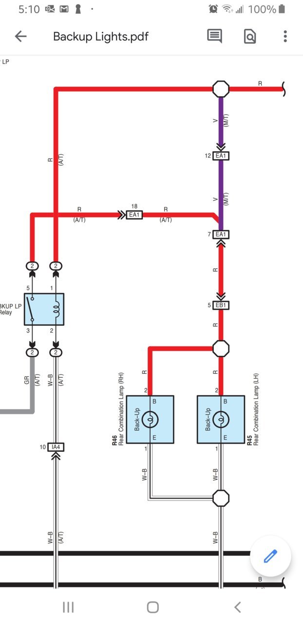

    I'm trying to install tailgate light bar witch is pretty easy. I want to know if anyone knows what color wire is the reverse light? I have to connect the white wire coming from the light bar to the reverse tail light does anyone know?

    Red is 12+ and White/Black is ground.

    Thank you very much ..
