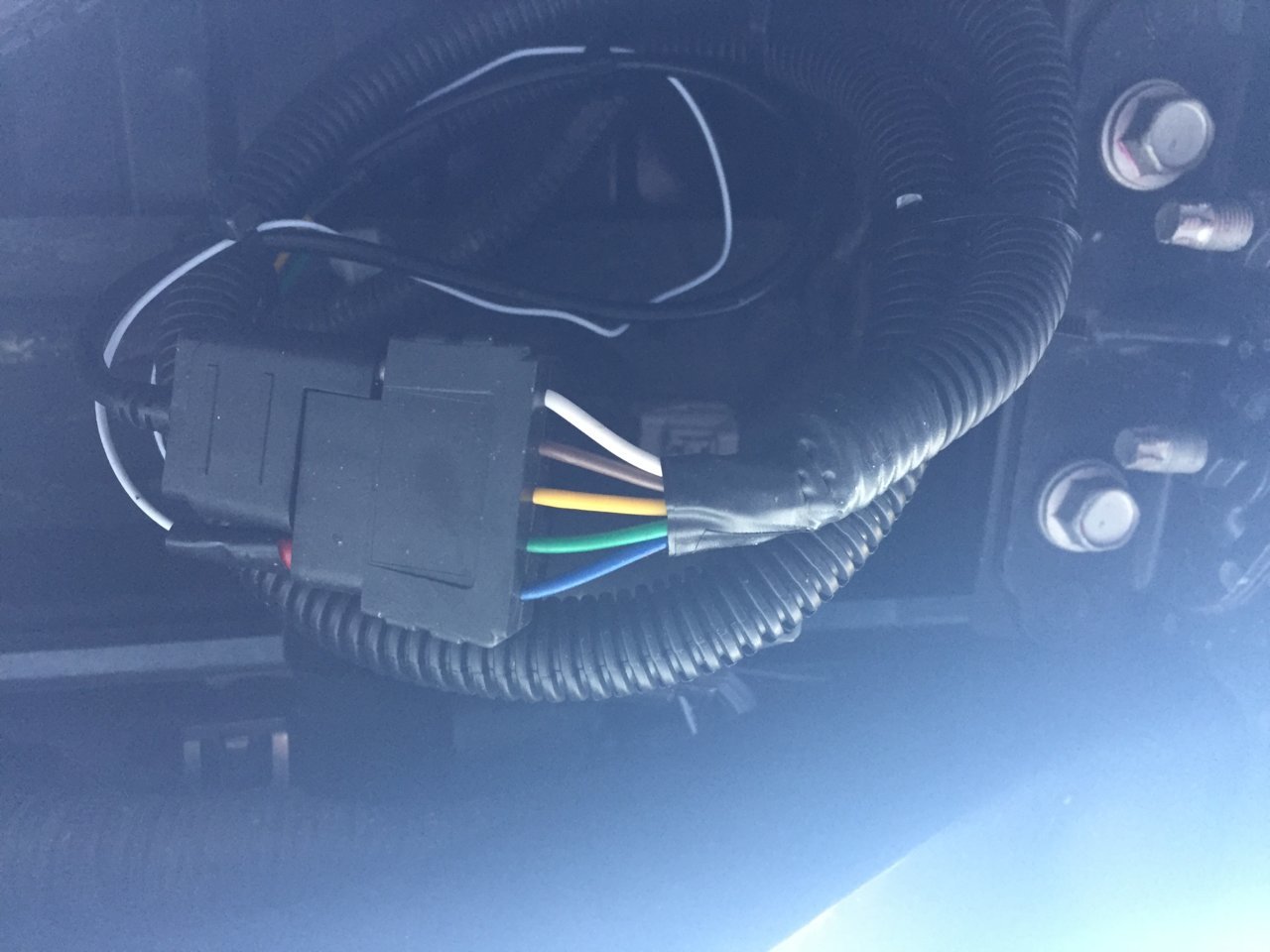

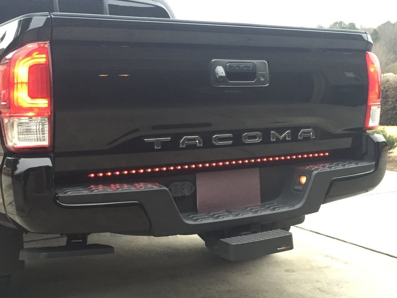

    For ease of install and a clean look when I installed my OPT7, I used a CURT harness 56584 plugged into the towing harness behind the bumper... it allowed for the white reverse wire too (using a bullet connector) so I didn't have to undo the taillight to get to the reverse. Here's a poor pic of it...

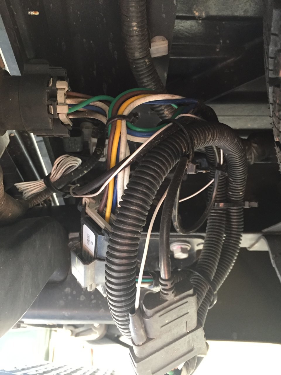

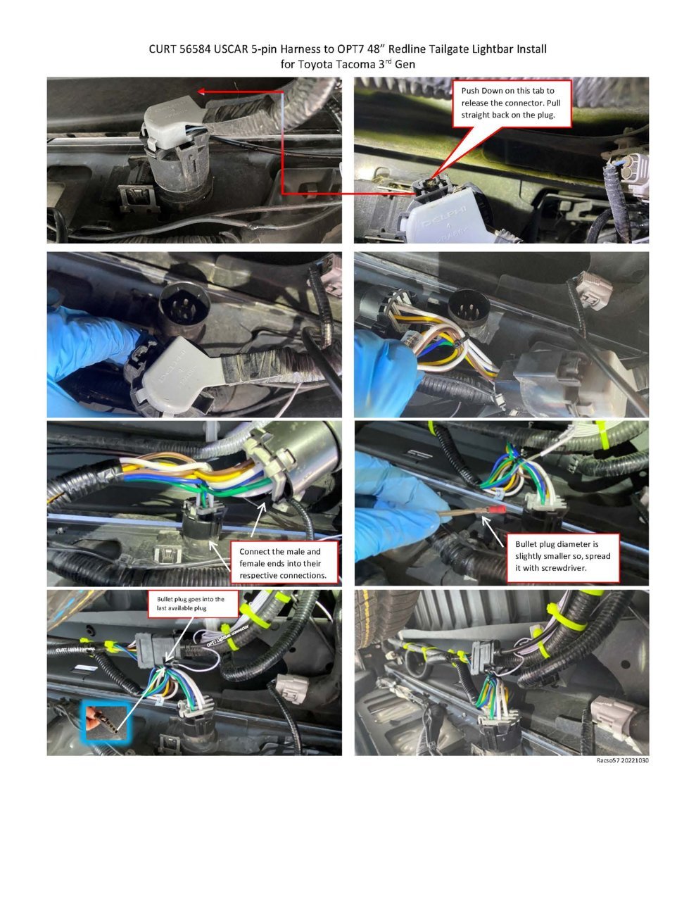

    The harness (see pic, yes I save all boxes..) comes with all connections needed. You detach your existing 7 pin plug from behind the bumper outlet, plug it into the harness and use the plug on the harness as your new 7 pin plug for towing. The harness has a 5 pin plug tail on it that your new light bar plug attaches to. Use a bullet connector for the white wire (reverse), zip tie it all together and you are good to go. I took a pic of the connections best I could...

    Thanks for this write up! This is exactly what I needed to know for my '16 TRD Sport. No fuss, no muss & the bullet connector is an awesome tip!

    @gatriguy, did this same setup following what you did for my 21 trd sport and this is hands down not only easy but clean
