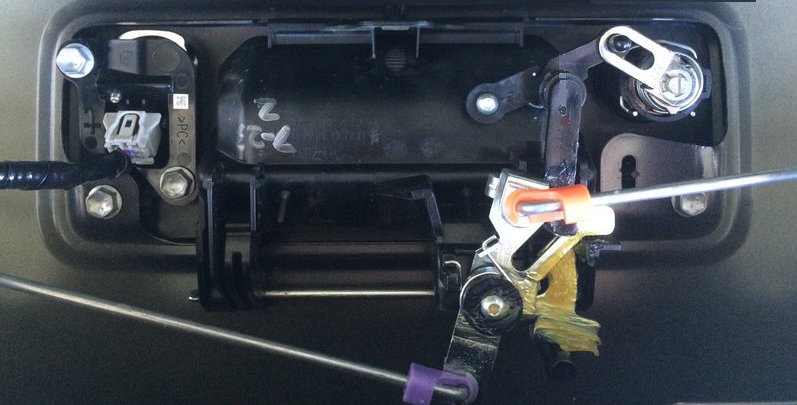

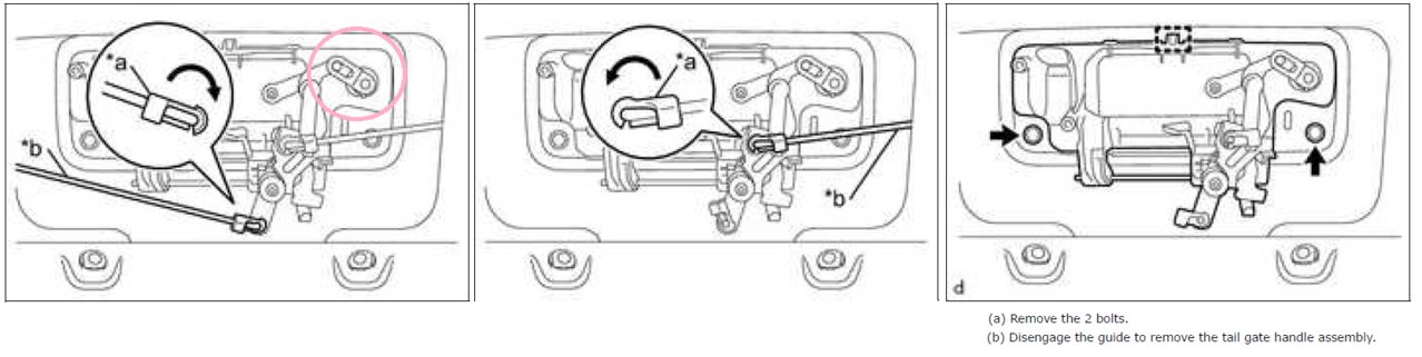

    you can probably remove the lock cylinder somehow. There's probably a clip or something like that, that will hold it on. However, it's tied into the whole black handle assembly, which is held into place by 2 bolts. If it's not damaged, it would be a lot easier to just swap out the whole thing versus swapping just the lock.

    Yes...remember the camera connector also...

    just swapped out the handle and lock and took a solid 5 minutes haha super simple
