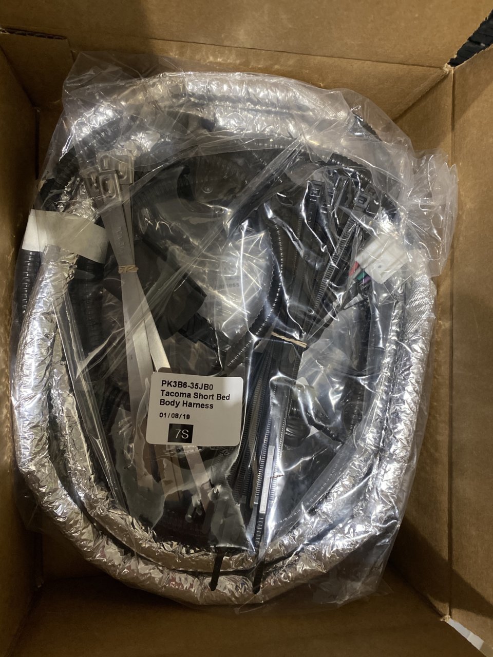

    It's not a pop'n'lock, at least not for the last couple of years. Here is the OEM kit I referenced. It comes as plug and play with an OEM Y-harness that you run up the right side and plug in at the right footwell. It even includes a cab seal that replaces the one you pop out from the floor under the passenger seat.

    I did install it myself. With the OEM kit there is no splicing. You simply plug in the Y-harness near the passenger side footwell and the OEM plug you pop out plugs into the other side of the Y harness. Then you run the harness under the floor (it includes a new seal for the cab floor hole you use) and back to the tailgate area. The OEM instructions I included in the previous post are for the kit. The OEM kit includes new wire clips as well so you end up with both harnesses side-by-side going in and out of the tailgate/bed. It looks great. The only pain part of the install was running the new harness behind the exhaust because there isn't much room to get in there with the included metal wire ties.
    I think the pop'n'lock is fine too, but the OEM is a slightly easier job I think....and it's not as loud when it operates.

    Cool! The Toyota kit is more expensive than the pop & lock but it looks like you get more stuff included. I see replacement wire clips for the tail gate harness with 2 holes. With the pop & lock you need to drill a second hole or you can take apart the tail gate harness and include the pop & lock wires in casing (as shown in the video). The body length harness with heat protection for around the exhaust area is better and the plastic casing protecting the wire all the way to the floor entry point is excellent. Wire splices usually have to be wiggled over time to reconnect because of exposed wire corrosion so tapping in with the Y cable is so much better.
