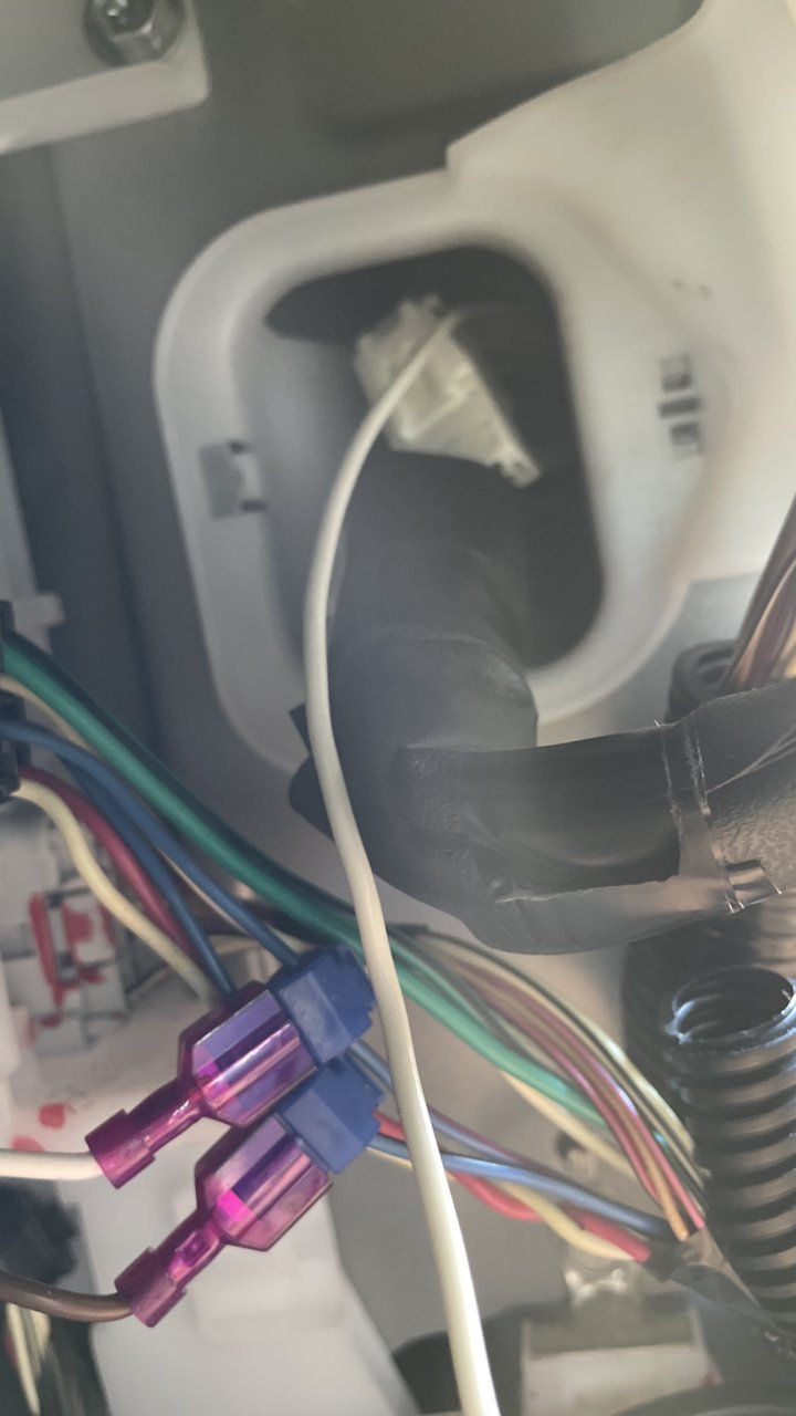

    Pretty easy. The instructions were great they even tell you what wires to tap into on passenger side. The two connectors are the power lock wires . Ialso added a fail safe feature just in case the motor for some reason quites on me I tied a nylon string to the arm that unlocks the handle and laid it in the tailgate and left the end near the drain hole so I could take a fish wire and grab it and release it manually 4B50E587-5668-4079-B704-F8D943C0CE29.jpg

    Look up the "paracord mod" as it relates to the tailgate lock. It's on here somewhere. Basically it's a bypass so if you're locked out, you fish the cord out and give it a yank and it unlocks the gate
