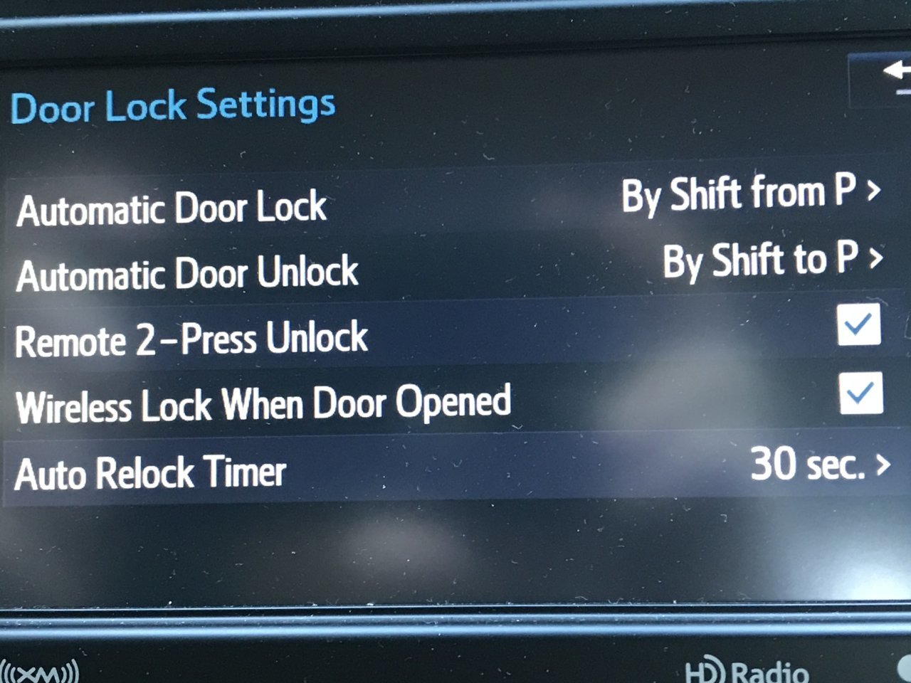

    Uncheck the remote 2 press unlock box. Settings should match the below.
    Your "Select Doors to Unlock" setting doesnt seem to be there? That is strange. Is that not an option for the SR5?

    Seems to be a 2018+ setting.
    Comes with Toyota Safety Sense.

    Nope I am a 2017, no safety sense. And mine shows the option.

    You may be right 2018 SR5 with safety. I have tried to change the settings but no luck. I’ll see later today if I can change anything. Thanks guys

    Oh, Im talking about the Wireless Lock When Door Opened setting (2018+) that replaces Set Doors to Unlock (2016-2017)

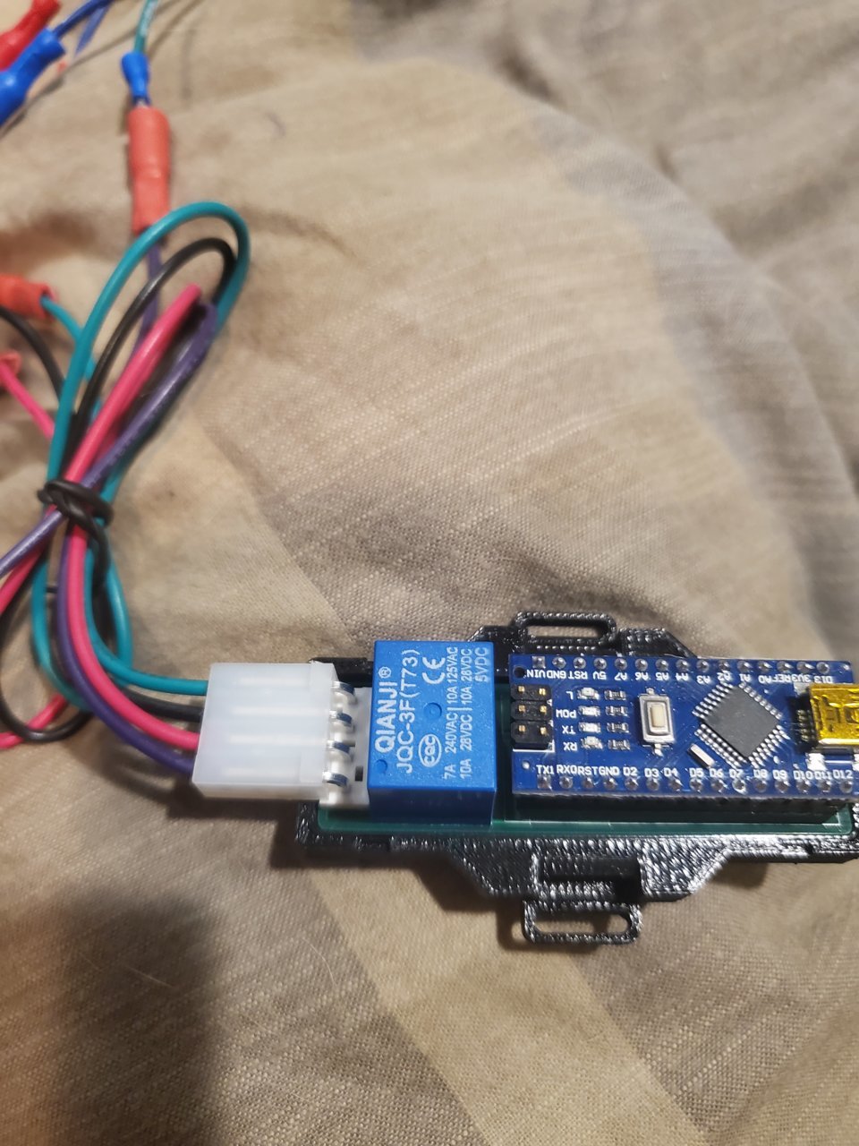

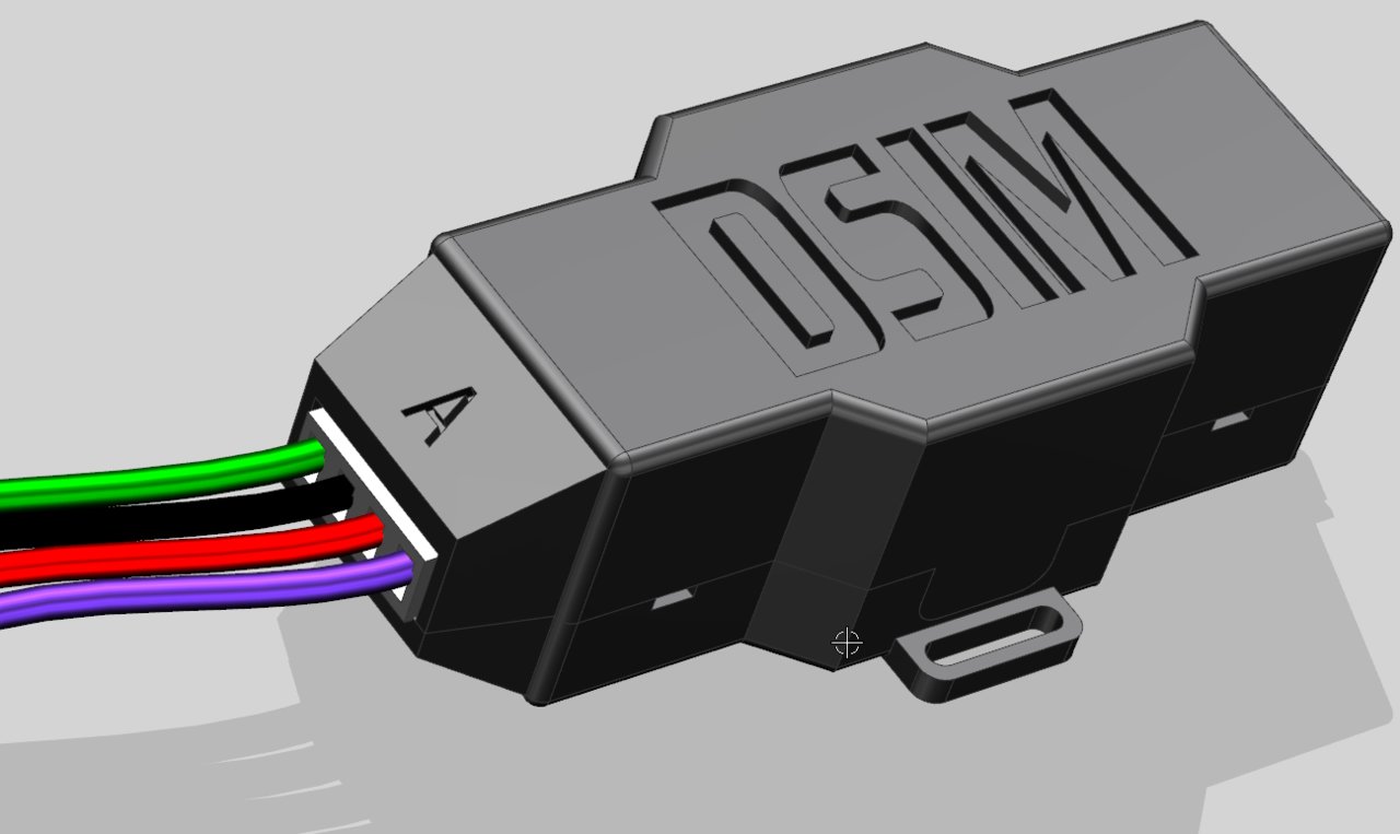

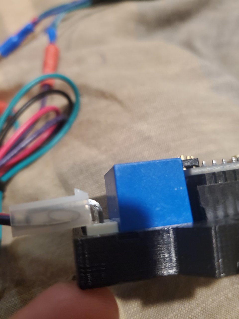

    I'm a little confused the picture shows that the little "tab/ears" on the connector should be up but the wire colors do not match as seen on the pictures above what's The right way? (See pics below)
    Should I follow the wire colors or the tab/ears on the connector on the up position????

    That's the correct orientation. The picture that looks like a 3d model is wrong. I need to update it. The wiring diagram is correct though.
    Either way. The picture you show is correct :thumbsup:

    No problem, thanks for checking first before installing! Apologies for the confusion, gonna update that photo hopefully tomorrow just gotta grab new screenshots.

    Also, I have updated the enclosure to better protect the A-Connector. I also tightened up the clearances to make it install-able in only one orientation to help prevent the mixup of connecting it upside down / reversed.
    I'll be updating my first post and the website with the new style enclosure pictures here in the next couple days.

    Thats super nice . Looks like you added everything to this model .
