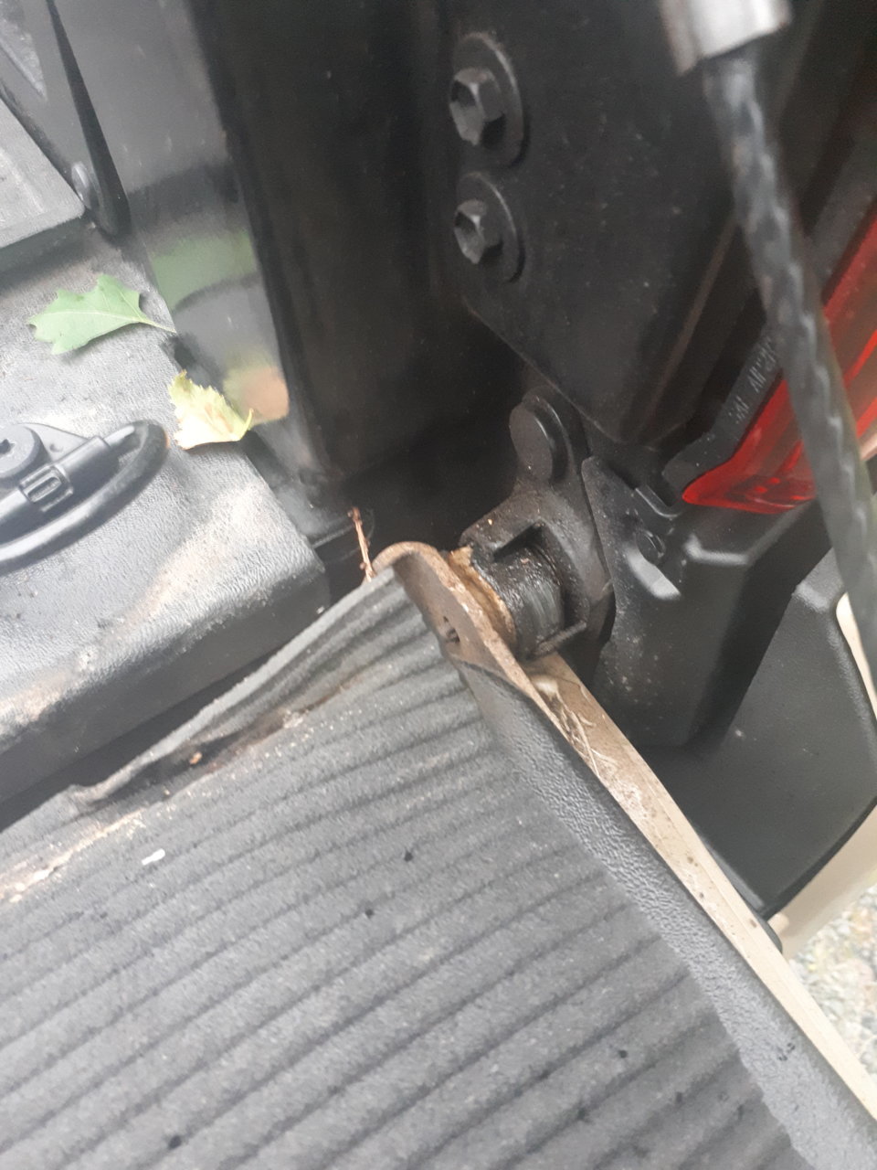

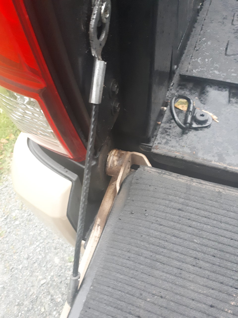

    Noticed that when I had my tailgate down today that one side was different from the other. Is this normal or am I missing a piece?
    Thanks!

    No ... this is designed to let you lift the gate on that side to remove from truck after releasing the cables.
    Easy to remove and unfortunately steal.

    Put a hose clamp over the passenger side, it will help slow down a thief.
