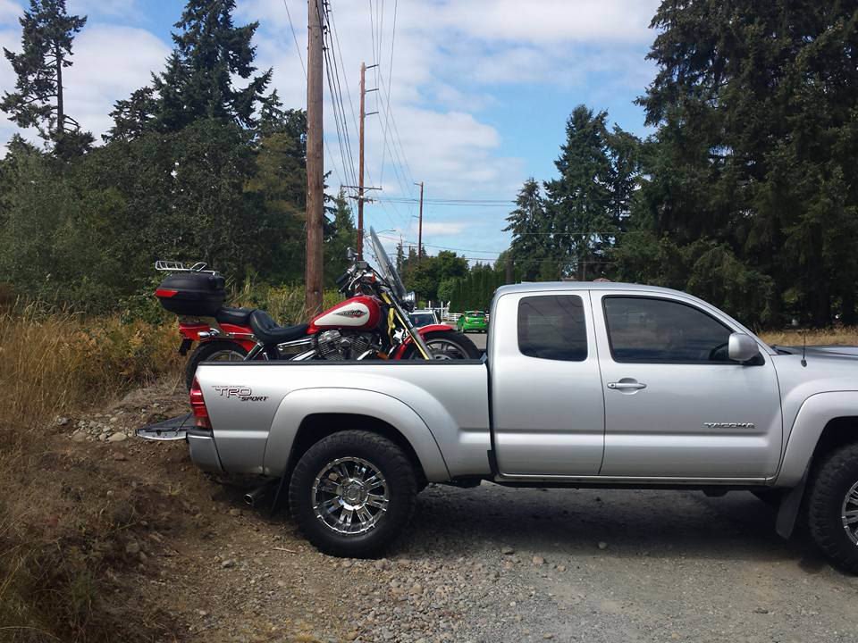

    I would actually like to have the tailgate supported but I have loaded up my 1100 Shadow in the bed several times without and no issues yet.in the bed.jpg

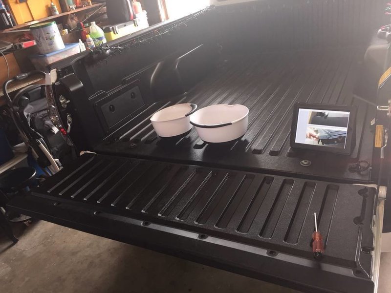

    Soooo, what is different about the '15 tailgate? If you order a new OEM tailgate shell, do you automatically get the stronger tailgate? The inside pic above looks just like my '06
    bluezzy likes this.

    I was refering to the pic above yours. According to his profile, he has a '15

    on mine the tailgate feels rather wimpy... I should get a brace for it also... I do think my bike is about 100 pounds or so lighter than yours.
