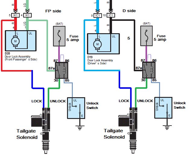

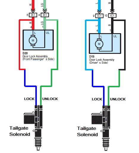

    For those wanting/needing a separate switch to unlock the tailgate solenoid.
    As it's installed without the extra unlock switch.
    With the extra unlock switch -Front Passenger's side
    and Driver's side.
    Tailgate will unlock and lock with FOB and door switch. Added switch only unlocks the tailgate solenoid. No other door lock is activated with added unlock switch. Tailgate solenoid locks with system/circuit lock. Added switch needs to be momentary ON. (ON)

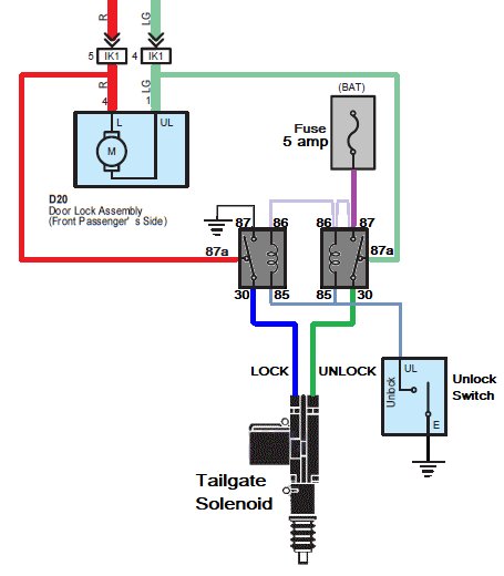

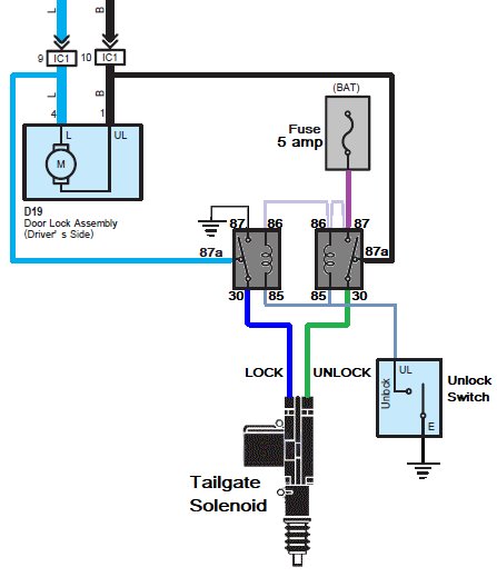

    This will also work:
