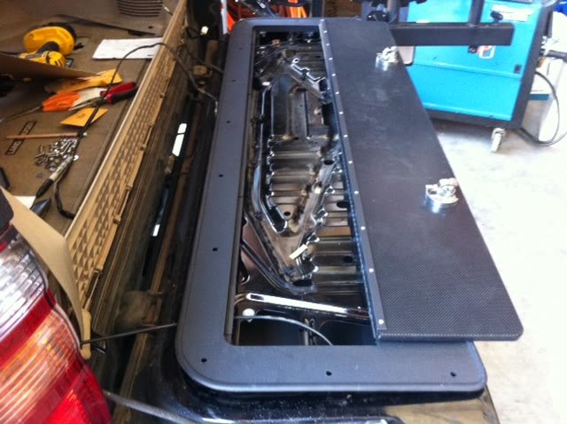

    Found this site called wagongear.com and for series 60 LC might fit (I am not sure as I haven't measured the width of the 1st gen tailgate.
    series 60 here

    Yeah, that's the one I remember now from the Land Cruiser website. Those are a great quality product. But they are also on the inside of the cabin. On the Taco, unless you run with a canopy or something, it might need to be different material and some sealing out the elements type of mods. I was thinking a decent gauge aluminum would be nice and also help reinforce the tailgate as well.

    I found that site too. I think that's the product in post #1. Watched some videos. He essentially made a lid for the tailgate. I think I'm going to try something similar, possibly raised a bit for some extra volume.

    That's just it, most of it IS contained. I have a few ratchet straps just thrown on the rear floor just out of laziness, but my recovery gear is usually packaged up in a canvas bag behind the rear passenger seat. I have an amp under my driver seat, but there's just as much room under there (height wise) as a compartment inside the tailgate (as I see it anyway).
    You could make a nice little drawer under each of the front seats to store stuff... That would be less fabrication than cutting up a tailgate.
    Plus, the tailgate isn't water proof, so whatever mods you do, you'd need to waterproof it unless you don't mind the things you're storing getting wet. Also make sure you don't have an area that collects water inside the tailgate, where it will rust and/or mold.

    Ran across this as a model for a possible solution. I think this if for Jeeps.
    The tailgate does have drain holes, but you're right; you'd have to put things you want to protect from moisture in something.
    My first thought was a fully self-contained unit that would drop in the cavity. That would protect the contents. Basically, the Wagongear lid with a plastic or fiberglass container attached to the bottom.
    Lots of good discussion. We'll see how this goes. It may be a fool's errand, but I like the challenge.
