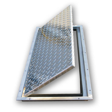

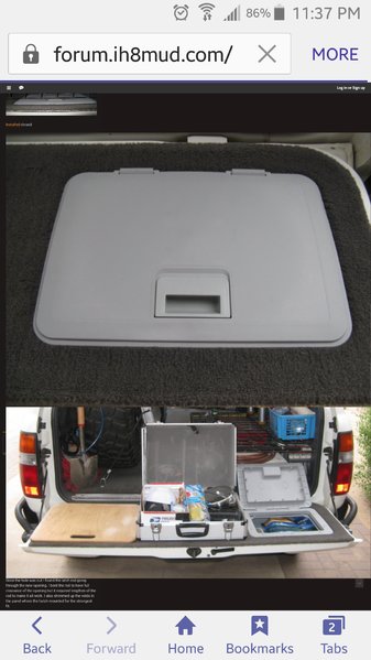

    New type of deck plate mod? These rectangle marine deck plates wouldn't be too hard to do either for smaller cut outs. Waterproof as well

    There's a West Marine about 5 miles from my work. I may have to stop in there on my way home. They'll have latches too.

    Nice find. Ran across a few marine outfitters looking at latches. The Wagongear unit is basically the same concept as these inspection hatches, just bigger.
    SellyKlater[QUOTED] likes this.

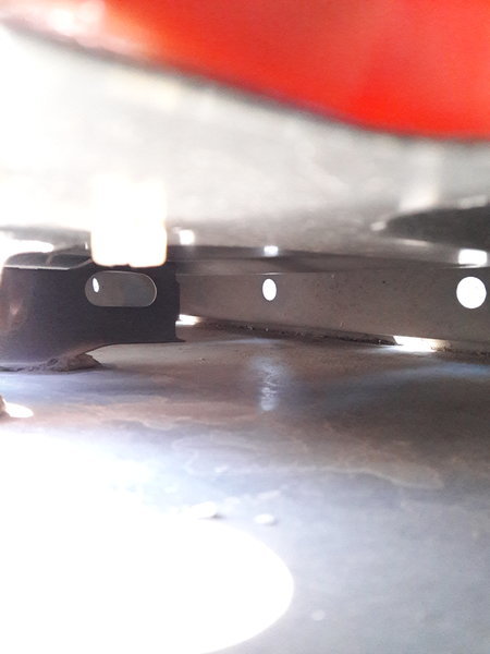

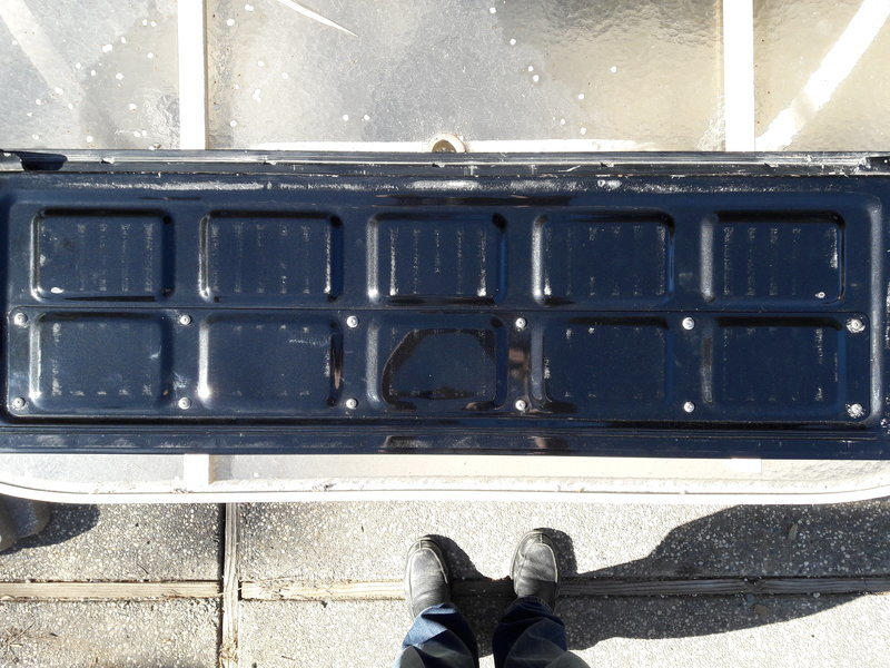

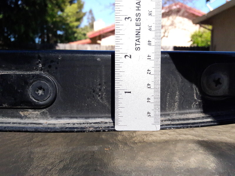

    A sacrifice to the mod god. Approximate outside dimensions of the box: 52.5" x 15.75"
    Approximate max depth

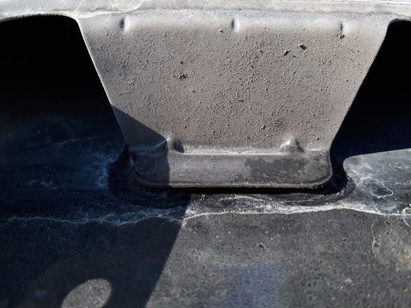

    Access panel removed. These supports are attached with some sort of soft, silicone-like substance. It's a bit springy.
    Close-up

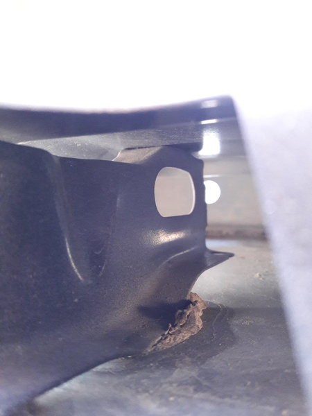

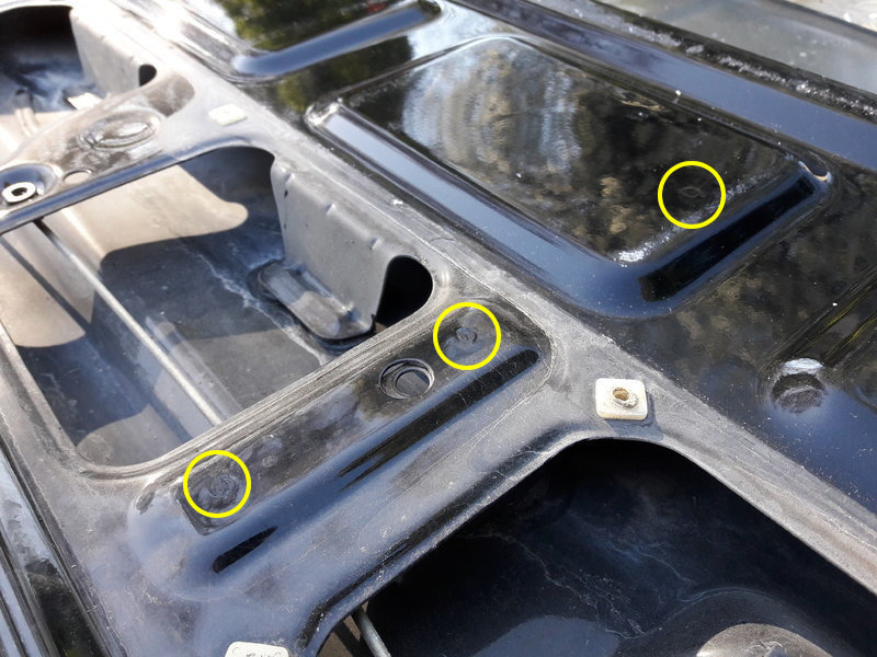

    The spot welds. The internal support spans about 9", which is less than an inch passed the welds in this photo..
    A look inside toward the bottom left.
    One of three spot welds.
    More of the silicone-like substance.

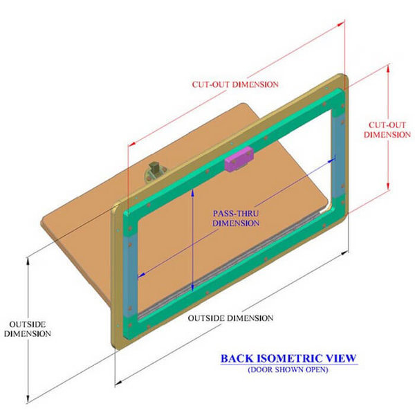

    This is pretty much how it would be constructed.

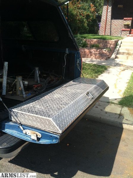

    Found a unit that was described as gun storage. It actually just attaches to the tailgate without cutting anything. It's pretty tall, but something similar could easily be used to add some volume to the storage space. Even an inch would make a big difference.
    Combine that with something like this maybe?
    I think the Wagongear unit is pretty nice. But to hear the people talk about it on other forums, you'd think the guy was an engineering genius. Essentially what he did was model his product after an existing marine product. Can't hate him for it.
