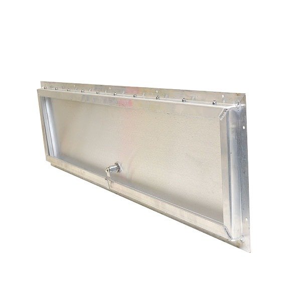

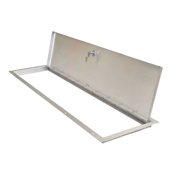

    After seeing how the tailgate is constructed, not at all concerned. The two ribs and the "tabs" are there to keep the thin sheet metal from caving under load. Press on the right spot and you will still bend it. The lid design would be of a much thicker gauge and you could incorporate ribs to mimic the originals, but I don't think that would be necessary if you design the frame properly.
    The Wagongear unit is a good example of spreading the load to the perimeter to eliminate the need for any internal support. He has some pictures of him standing on it supported at each end.

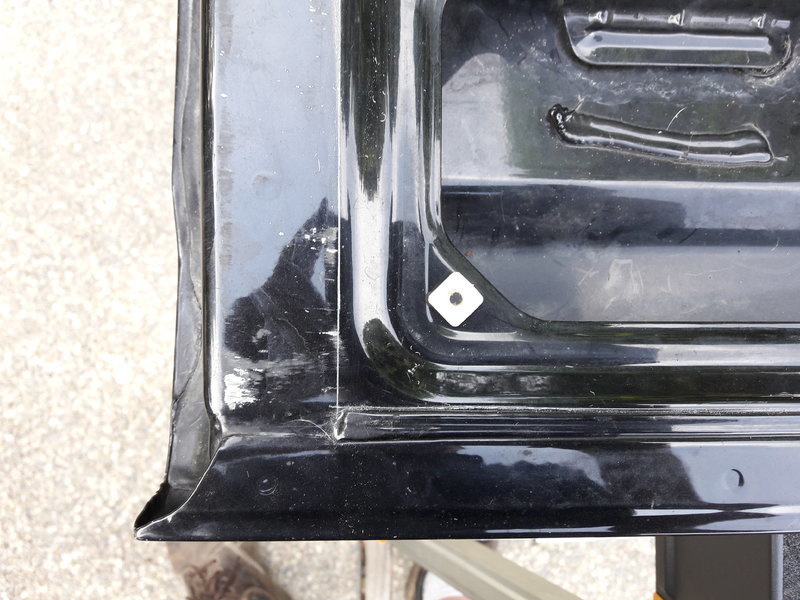

    Ok. It's been a while since I've posted something. Been busy with other projects and things. Picked up some tools to help with cutting the tailgate and fabbing the lid.
    I want to cut as close to the bevel (?) as possible to leave the maximum amount of surface area for the lid.
    All I managed today was marking the cut line.

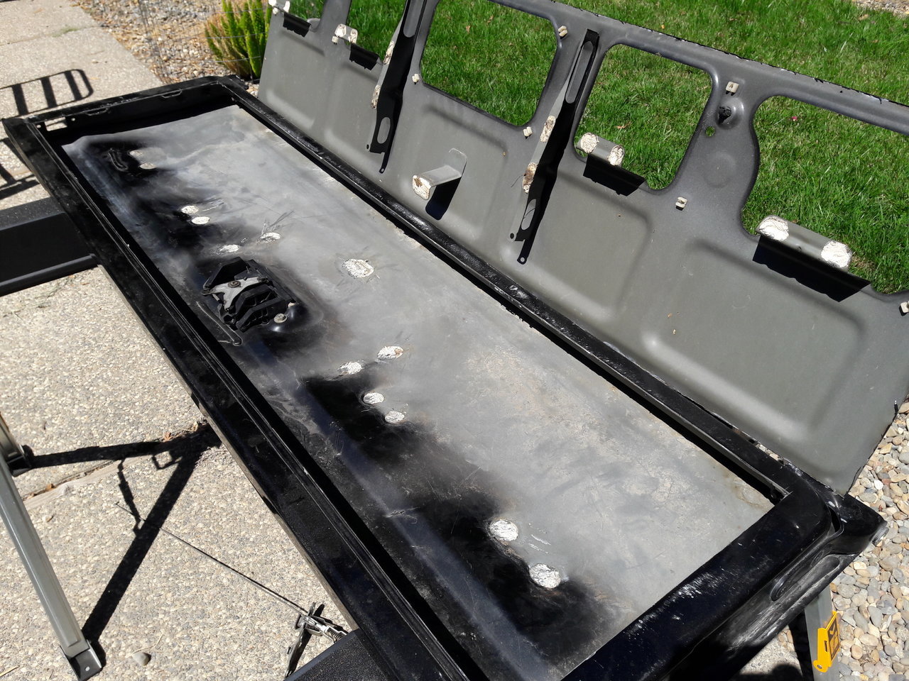

    The anatomy of a first gen Tacoma tailgate.

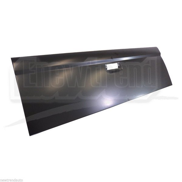

    I'm leaning toward a hatch design along these lines.
