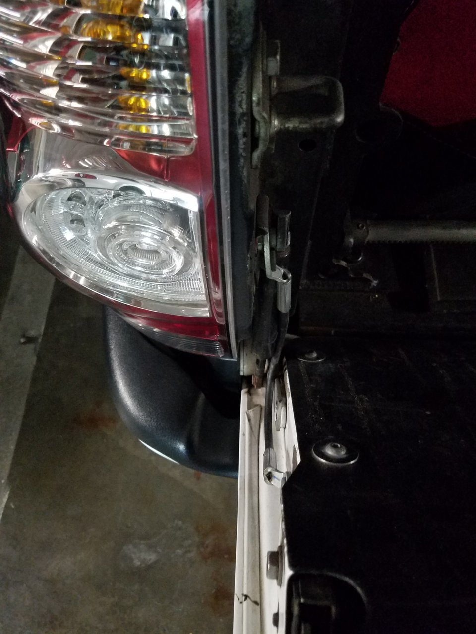

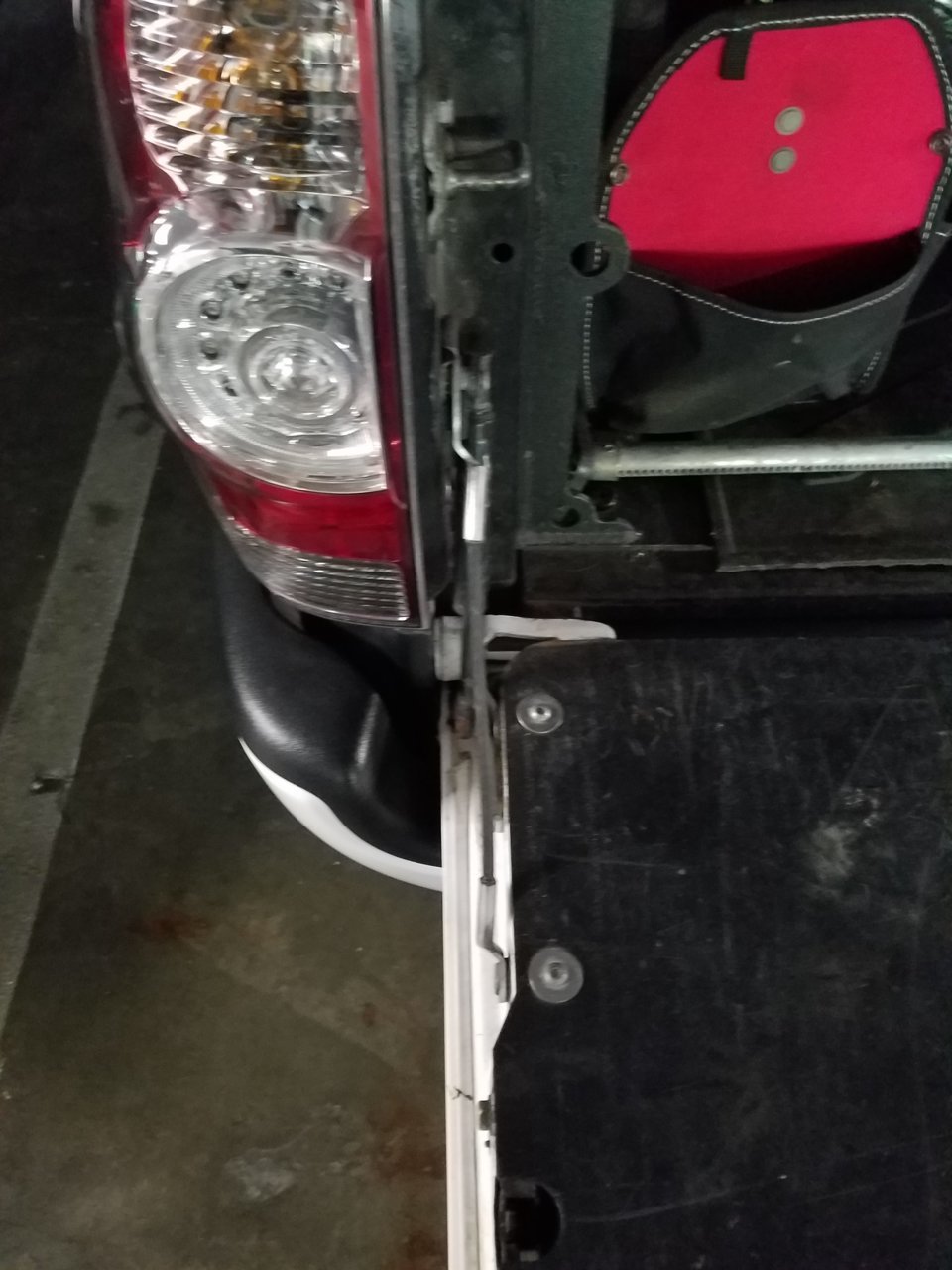

    With EZdown, trim panel like how this mobtown tailgate skin is and kind of mold the cable to go on side. Works good with out rubbing .It just closes in that position all the time . Best part with tailgate cap and skin, its pretty heavy .Now I just open and let it drop without slamming . Down side about 8 inches to closing it gets a little harder because of lift strut . Been 2 years or more and cable no scuffs ..
