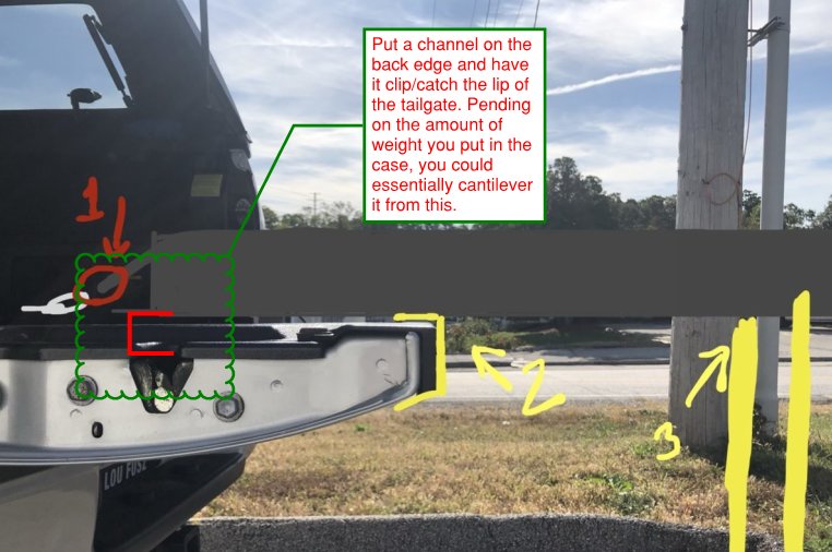

    Sorry for the chicken scratch and bad photos...

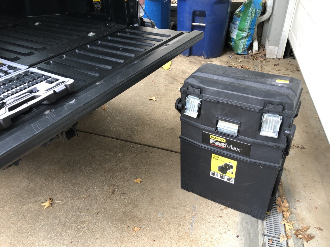

    @0xDEADBEEF , I would want this to work double duty as storage as well, storing all of my kitchen items inside.

    Well, you could set the apache case on the table. I'm not being sarcastic, for once. I'm just one of those people that tries to avoid single-purpose setups.

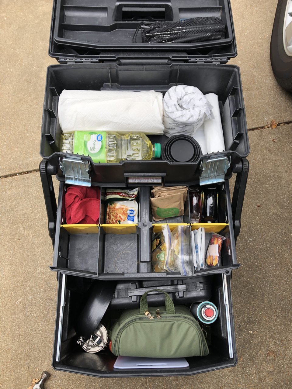

    @USMC - Retired , indeed, the utensils would be inside a smaller bin inside the case, the stove is stored inside the case, and anything else would also be inside a smaller bin, when I get to camp, I would empty the case entirely, then, use the case as the work surface. The accompanying bins would be then stacked in the bed for ease of access. Therefore not needing to access the inside of the case at any point until I pack up the kitchen items.

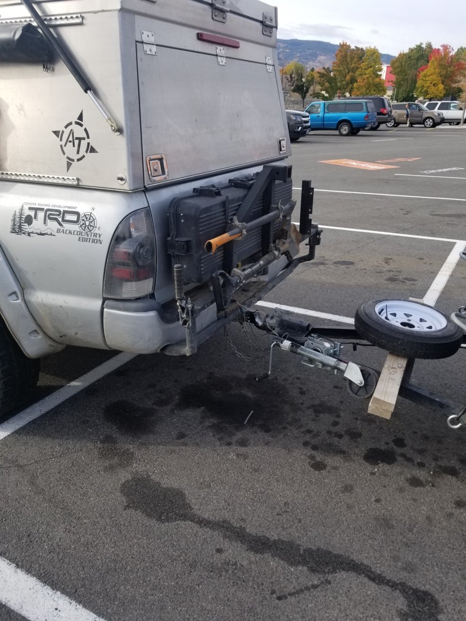

    I'm not at home at the moment, but I made a lightweight swing out around factory bumper, original idea was to use one of those swingouts that mount in hitch (Wilco or even a swingout carrier for mountain bikes) but I wanted something more permanent. Here is a quick picture I just snapped in Walmart parking lot. I have a bunch on my comp at home that depict the process better I can post later if youd like.

    not sure of your budget, but what about a hitch mounted swing out bike carrier and mimic what excorcist has done?

    You could also actually use 3 sets of some z-clips and build a frame with them. Put part A on your tailgate, then put part B on the bottom of your case. You should be able to then simply slide it into place. Since it will be supported on 3 side, it shouldn't rotate on you and it will still cantilever. You would probably want to use some pop rivets to secure everything to your tailgate and the case. Just remember though that the part A frame would essentially be a permanent fixture on it.
    I don't know if that makes sense or not?
  18. Oct 18, 2019 at 8:55 PM
    #38
    BKinzey
    BKinzey Well-Known Member
    May 5, 2016
    #186211
    1,483
    Beauford
    Hollywierd, CA
    2015 White Tacoma Access Cab TRD Off Road 4x4 V6
    RCI aluminum front skid, SnugTop, Sliders, bedside supports, LED interior, CaliRaised fogs & brackets, rear diff breather mod, DIY bed platform
    I think this is the best easy & cheap solution. The one drawback is the pieces will need to be attached to the case and tailgate. It should have a low enough profile that it might not be that much of a hinderance.
