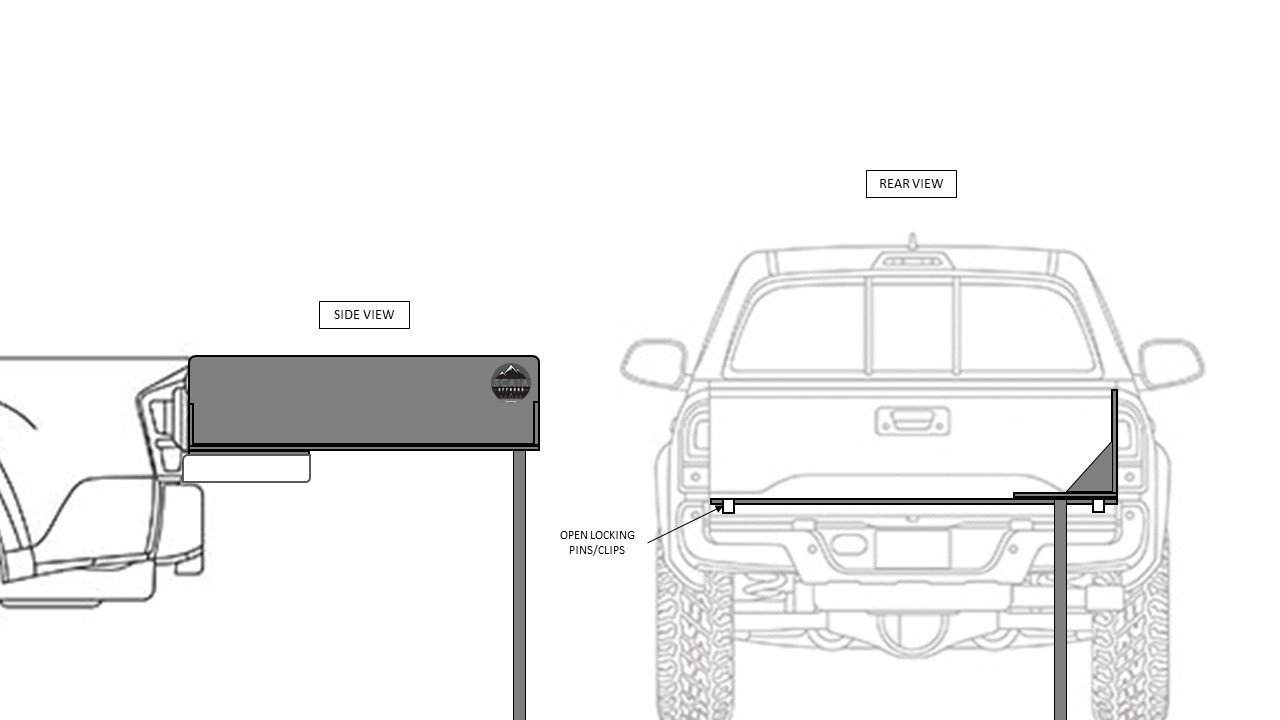

    Hey I don't know if you have come up with a solution to this or not but I have just started working on a prototype for a tailgate extended outdoor kitchen option where you don't need a steel swing out bumper. Don't know if there is anything out there currently or not but excited to see if I can make this concept come to life...

    the only issue I see with this design, and OP's previous one, is the length of the legs.
    Just gotta be sure the length of the overhang from the tail gate is greater than the distance needed for the legs, or else you either won't be able to close the legs flush, or you'll have to rotate them 270 degrees the other direction to have em lay flat (in OP's example with the legs mounted on the side). In yours, there's no option but to either use telescoping legs or be sure the height of the legs is less than the overhang off the tailgate.

    Yeah thanks for the feedback. the pole would be telescoping to accommodate elevation changes for sure. currently working with a CNC machine shop to come up with a prototype.

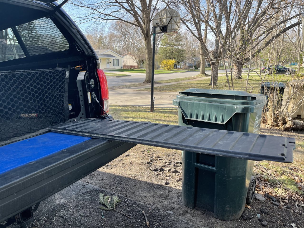

    Pretty easy to utilize your bed stiffeners if you got em!38E477AB-ED78-441E-8696-8D28F0B5F79C.jpg

    With a bracket and the right table, this can be perfect.

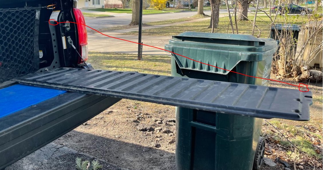

    sorry for the crude illustration, what if you used an eyelet at the outside order, with some cable and a turnbuckle for adjustable tension

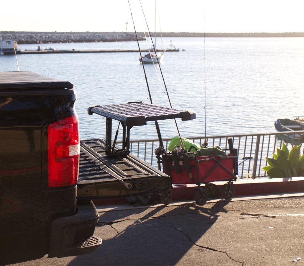

    Napier truck bed tent EEZTOP folding table
    you have a good idea there! - my neighbor got this tailgate folding table from EEZTOP... I just ordered the smaller one for my Tacoma camper :thumbsup:. It's nice to sit on the tailgate bench!

    looks a lot like DP harbor:cool:

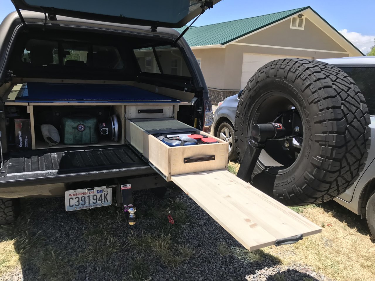

    I built mine into my drawer bed system 0BBBC90F-5052-4D1F-8962-6050E2D0DDD3.jpg50CCBA03-11F2-4662-A2B7-AFCB6EFB51D3.jpg
