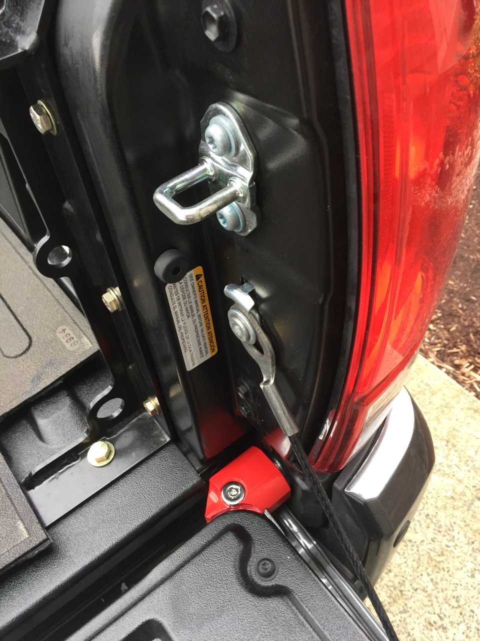

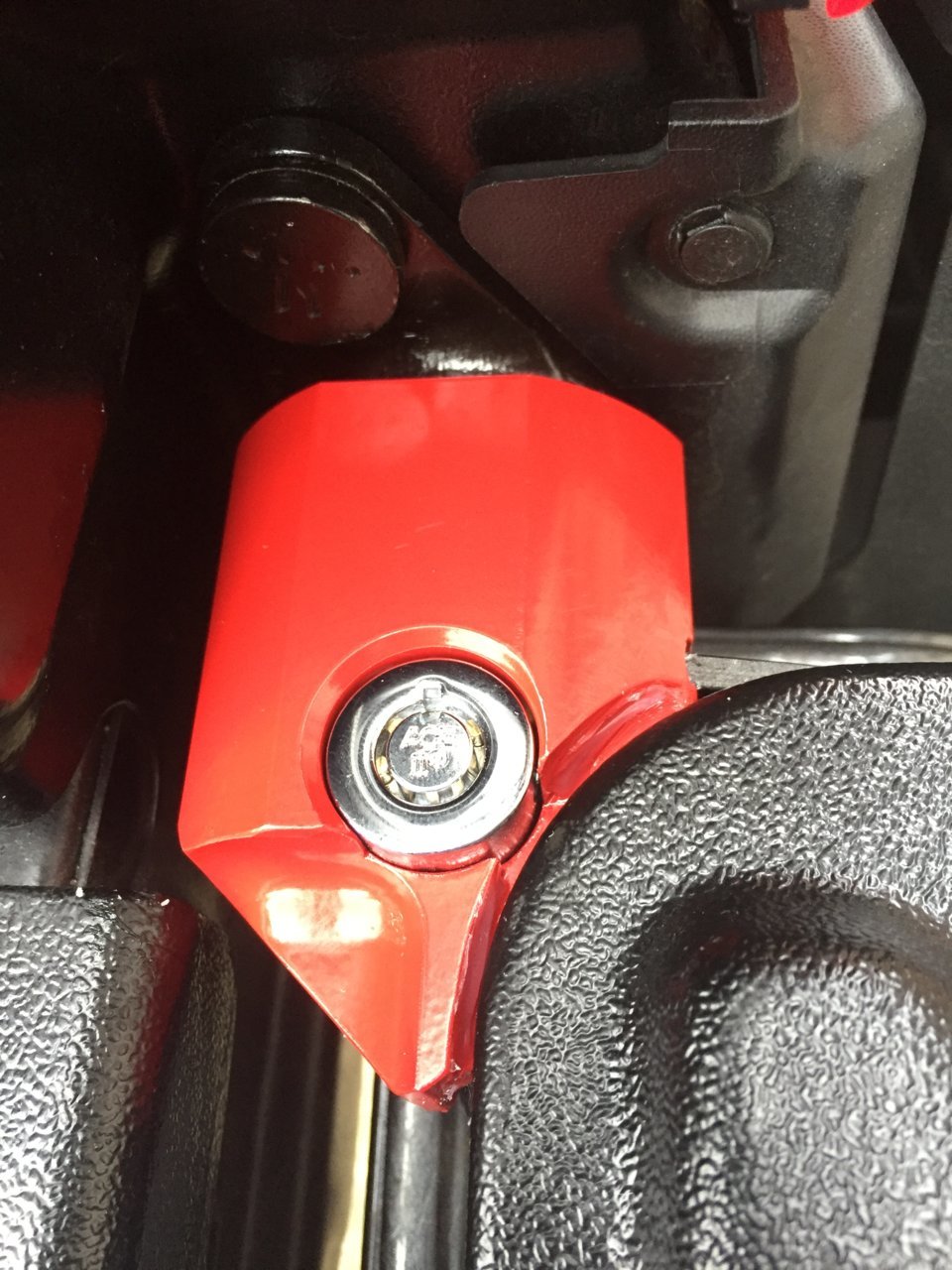

    Just installed my tailgate theft deterent bracket purchased from christian06. Primed and finished in Barcelona Red. Hopefully I'll never loose my tailgate!20200716_135731.jpg

    Now fill the hole with some epoxy, silicone or caulk and slow them down a little more.

    Sadly, I'm one of the people that mangled the shit out of that screw trying to get it out, thanks to Toyota and all the gooey shit they put in that screw. So now that device is just collecting dust on my shelf. Oh well, ended up installing the oem power lock instead.

    It was tough to remove, they (Toyota) had thread lock blue on)...

    If I could do it all over again , I'd dig as much of that gooey shit out of the head of the bolt as I could and have someone hold the tailgate as I unscrewed it, instead of trying to hold it myself.

    You may have to drill it out...only way. I did mine by myself but it wasn't easy.

    Whatcha mean hold the tailgate? U pulled it off?

    Just unhooked the one side and leaned it on my knee. At the time didn't feel like unhooking the camera wire... Oh well

    Can u loosen it while it's still attached or is the tail light Area in the way?

    It's a tight fit, I suppose if you have the right tools. None of mine would fit with it still attached.

    Wait so how do u install the device then? You'd have to wait until it was installed to tighten it right?

    There's already a factory bolt that needs to come out. It's covered in gooey shit and loctite in place. Take the bolt out, pop the device in then secure it with a tamper resistant bolt
