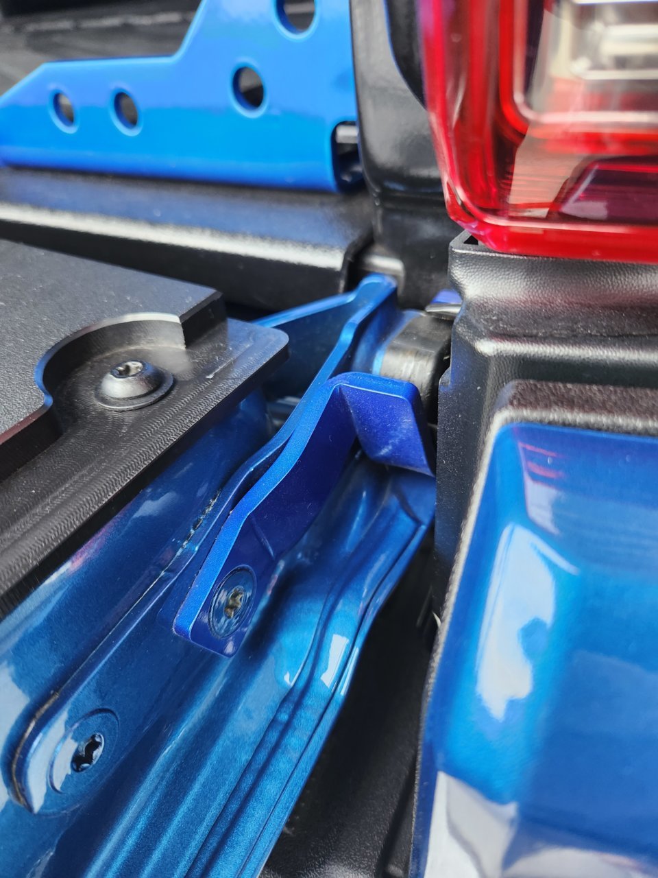

    On the bottom corner of the tailgate, directly below the hinge, the outer skin of the tailgate is folded over and crimped. There is seam sealer applied to keep out water and on some, like mine, it is applied pretty thick and doesn't leave enough room to get the bracket on. I took a sharp chisel and shaved the sealer down a little bit and the bracket slid on easily then.

    Prep is the key to getting torx bit out. Remove tailgate and lay in bed, remove "gooey" stuff from around screw, carefully remove paint from around screw head, using proper torx bit and small breaker bar remove screw. Mine popped right out. Love my anti-theft device!!

    Theres no video but it is a tight fit and once you find the sweet spot it will slip right on, feel free to contact me for any other questions

    I found that sweet spot today, no chiseling of seam sealer needed. Then I started to strip the oem bolt so this project will have to wait until I read more on pulling that stubborn guy out

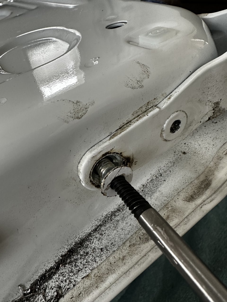

    So this was a fun endeavor. Had to use heat and drill it out. All that just to realize I took out the wrong one. FML... A good rehearsal. IMG_5405.jpg

    Now watch the other one pop right off. Do you need an extra T45 safety screw?
