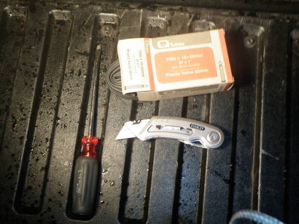

    Just did the hose clamp mod. I have way too much time on my hands today so I figured I would add a detailed write up.
    Here's what you need (forgot to put the hose clamp in the picture):
    •Flat head screw driver
    •box cutter
    •bicycle tube
    •hose clamp

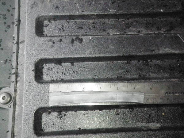

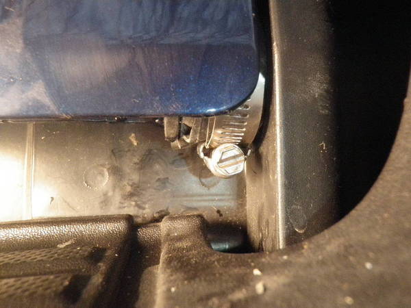

    To prevent scratching I put bicycle tubing under the clamp. I cut a length of tubing about 5" long. Then I sliced the tube sideways in half so that it wasn't as thick to ensure the clamp had clearance.
    Then I just put the clamp over the tubing and tightened it.
    Hope this helps.

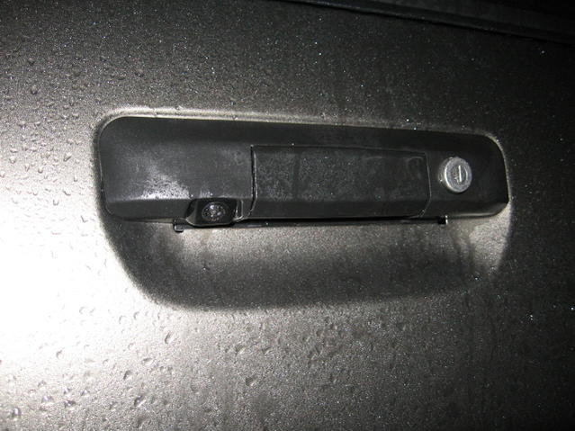

    You can. It is an after market PL5300 from Pop and Lock. It fits all second gen Tacos and will accept the tailgate camera on the '09 and '10's. I have both the hose clamps as well as the PL5300. Here is a pic of mine. It is a very easy installation.
