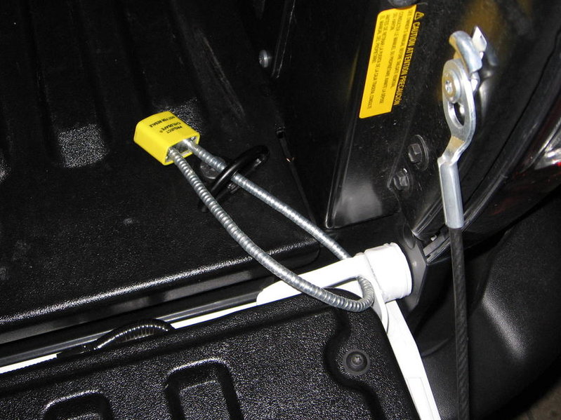

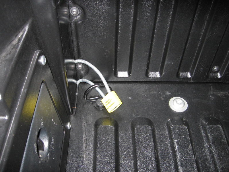

    Anyway, this thread had me so paranoid that I grabbed an old cable lock from my toolbox and ran out to the driveway at 12:45am tonight to see if it would work until I could get some clamps from Autozone. It actually worked well enough for me to be able to sleep tonight. I just hooked it to the d-ring that's in the corner of the bed. I also locked my Undercover tonneau which I sometimes forget to lock when there's nothing in the bed. Tomorrow I will do the clamp mod and probably the washer mod also.

    Can't the tailgate still be removed with the cable lock on? Just lift the tailgate out of the hinge and slide the cable off the end?

    No, I wasn't that drunk last night. Look at the first photo. I just looped it through the welded hinge brace and then through the d-ring.

    Oh, sorry, I see it now.

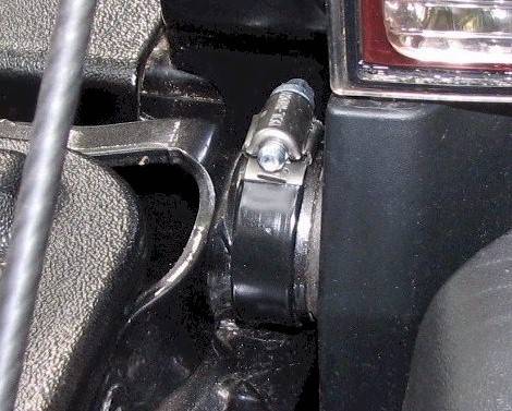

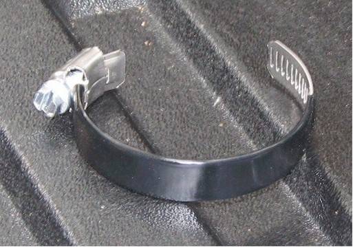

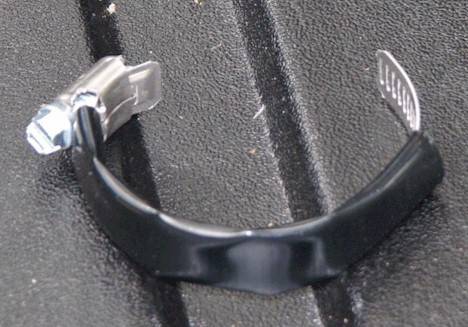

    I don't know if this will help with rusting issues, but this is the mod I did. I think it will at least provide a more rust-resistant solution, as the clamp will be covered by the shrink-wrap (at least from the underside). If you are really concerned about rusting, you could always change the clamp any time you see corrosion starting on it. This mod is so cheap and quick that you can do it over again whenever you become corrosion-concerned.

    That is a good idea. but it gave me a new one. their is a type of plastic paint that is use to cover handles of toos you dip the tool then let it dry an i became a rober if we use this on the clamp I think it will be better.
