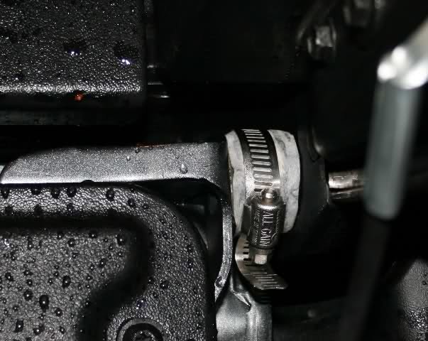

    I did the hose clamp mod today with a mod to the mod. Before installing the hose clamp I put on a couple of 45 pound plastic cable ties and then put the hose clamp over the cable ties. My thought was that the cable ties added an extra layer of security and also keeps from scratching the paint from the metal hose clamp. Then just for fun ran a cable ties around the tailgate cable bracket and the hole in the cable mount on both sides. I did not do anything to the hose cable to disable it in case I want to remove the tailgate. I fiqure that if someone wants my tailgate bad enough they will get it but if it takes too much time to get off they will move on to the next truck.

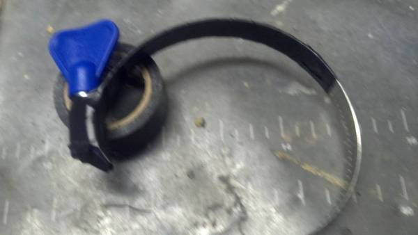

    I have some extra hose clamps with the key(see picture), pm me for my paypal address, send me 4 bucks for shipping and I will send you one to your door

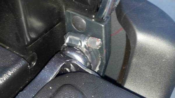

    WOW, I could not believe when I saw that video last night of the tailgate popping right off. Certainly my new 2012 with Premium Alarm had corrected that problem but this morning I walked right out and popped the tailgate off my new truck.My son laughed and said I bet Toyota sells a lot of gates.
    I went to walmart and they now only sell these clamps in a 4 inched for RVwaste disposal. I found them at O"Reilly auto parts with either red, blue or yellow handles. I measured and wrapped with tape up to the point that would enter the threads of the clamp to protect the paint. I also added a strip of tape when I was done and after I took the key off and I took a tire value cap and filled it with epoxy and stuck it on the remaining post. I figured all of this may confuse a thief and I would be hard to get to the post. My son called it the air-value for the off-road tail gate :)
    I cannot believe Toyota has not addressed this over the years. I live in a high theft area and I think this mod just saved me $800. Now who do I owe that beer to?
