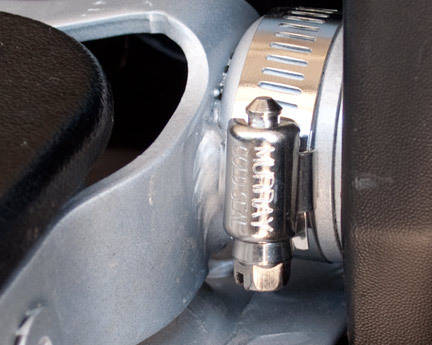

    I was thinking though, a would be thief only needs a screwdriver and and extra 60 seconds or so to get the clamp off, so I went a bit further and installed it with the screw slot positioned down. (facing the tail gate) In this position it's not possible to get a screwdriver on it, and it would be very difficult to work it off with pliers. I installed it with a small open end wrench.

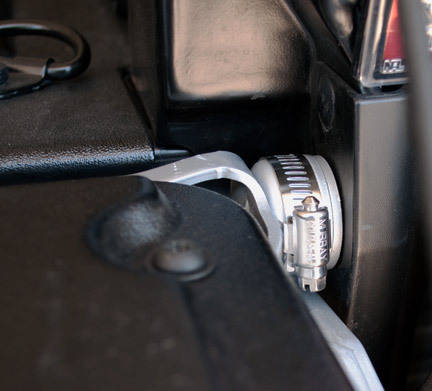

    I installed mine today as well. Used an Autocraft "Key" Clamp. Only took 10 mins. Peace of mind for $3.99.

    found a clamp in my dads garage, put it on with the nut facing downwards to further deter a theif. only took me 5 mins to put on, definitely worth it considering a new tailgate is a few bills! next im gunna see about locking the tailgate chains too. great write up!!

    Add me to the list too, $3.20 OTD for two clamps and one safe(er) tailgate.

    Just did both of these today. I thought I bought two 1/2" washers but they were actually 3/8" when I got them home and realized it. Still worked awesome. Put the washers on both sides (didn't lose that much thread) as well as the "easy twist" detachable handle hose clamp on the right side. Removed the clamp handle with no problem and am planning to lock it in my newly lockable modded console tomorrow after I do that project. ;) So now I've got a factory tailgate standard lock, a hose clamp and two washers to keep someone from stealing it. Between all 4, it'll take em' a while to get it, and require some tools so it's a time consuming deterrent at least.
