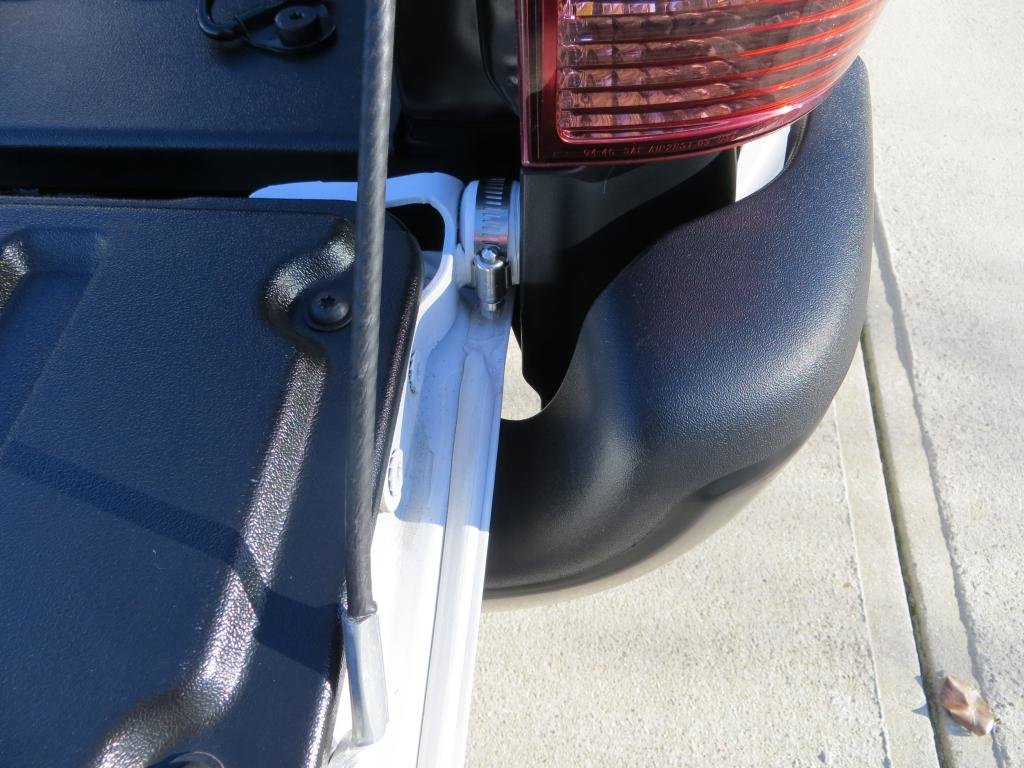

    First post. First mod. Big time thanks to all contributors for a quick, simple, and super cost effective piece of mind.

    I put heat shrink tubing on the Koehler/EZ hose clamp (EZ20 BK). My first mod. Next will be the washer mod.

    picked up the clamp and did this quick mod this morning!

    Did mine today. I removed the tailgate so I could wrap the pivot point in white electrical tape (I happened to have some). I also bought a stainless steel clamp (3/4" to 1 1/2"). So maybe it won't rust too quickly. I oriented the clamp to face the tailgate...hopefully making it a bit more difficult to loosen. I used a very small wrench to tighten it.
