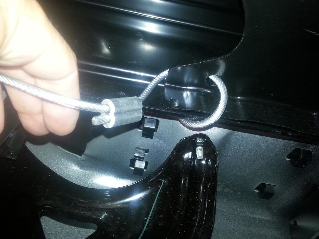

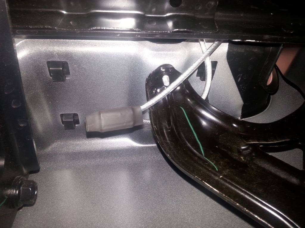

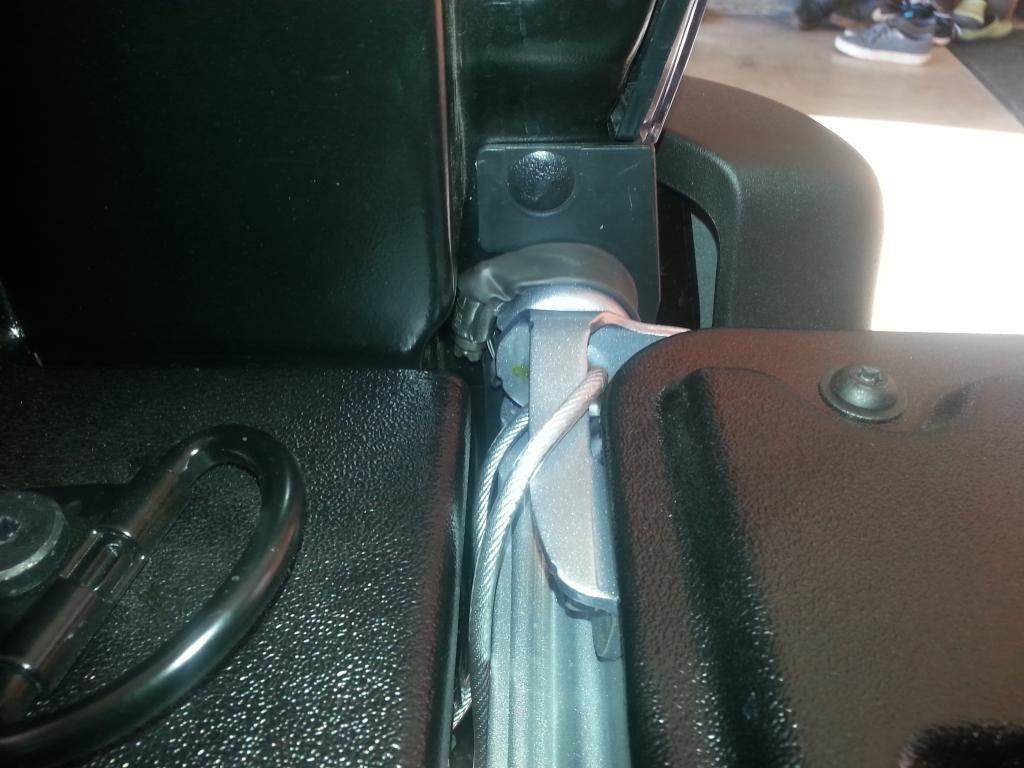

    Wow...lots of replies. I made it 23 pages then skipped to the end. May have been mentioned but I'll post again for impatient folks like me:)
    Brand new 2014 with camera. Wanted to keep my tailgate.
    Did the SS pipe clamp with heat wrap day two.
    I also added two 18" lengths of plastic wrap cable from the hinge to the frame. Secured with aluminum sleeves crimped in place, covered with heat tape. Installed both sides in about 10 minutes. Just another level of security. Could do loops and paddle lock if you remove your tailgate much.
    Does not interfere with any open/closing of tailgate. Cost for everything = $5
    Top view showing cable around hinge and clamp with heat tape
    Under bed, sleeve installed, ready to crimp
    Crimped and covered
