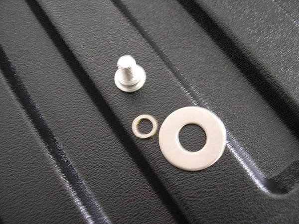

    Pictures added below, courtesy of, and borrowed from "maxboi". Just remember, that the small washer has got to be of at least, the same outside diameter, as the bolt shoulder (that the cable clip attaches to), and it has got to be at least the same thickness (maybe a bit more), as the large washer you are going to add.
    Also understand, that small washer, is simply compensating for the additional thickness of the large washer, by extending the shoulder length of the 40 torx bolt, allowing you to tighten that bolt, without binding the washer and cable clip. If that small washer (shim/spacer) is not at least of the same thickness, as the large washer used (maybe a bit more), then once you put everything into place, and you tighten that 40 torx bolt, it is going to jam the large washer against the cable clip, and it will bind, preventing the cable clip from folding in and down, as you close your tailgate.
    As for that small washer, it should have a 15/32" OD (outside diameter), with a 5/16" hole in the center (inside diameter). It should be approximately 3/32" thick, but never less than the thickness of the larger washer used. These measurements will mirror the 40 torx cable bolt, which has a shoulder that is 15/32" OD, and threads which that are 15/16" OD. This is probably not something you'll find on the shelf some where, but maybe (?) I believe it may have to be special made, if it is to be an exact fit.
    (Hope this is clear - I'll try to post pics, when I can)
    And yes, I am aware that many earlier posters, have suggested, applying loc-tight, then tightening the 40 torx bolt until it binds, then backing it out just a bit. I understand this procedure, but I really don't like the idea of having a bolt held in place with glue, alone. I prefer that all bolts be tightened, as they should be, along with loc-tight ! Just my opinion !
    Added pictures borrowed from "maxboi"

    Okay, I finally finished up this mod. I ended up taking four (4) stainless washers, which were initially intended for 1/4" bolts, and drilling them out with a 5/16" bit, so that the inside diameter would be exactly 5/16". The outside diameter of these washers was just over 1/2". I then took a 2" x 5/16" bolt, and slid on the four drilled washers (which now fitted snugly, with NO play). I then added a nut and tightened it up (very tight), with the help of a bench vise (for the bolt head) and a 1/2" wrench (for the nut). Once tightened up, this left approximately 1" of the 5/16" bolt threads exposed. We then put the threaded end into the jaws of a lathe, and turned the head of the bolt and the four washers down to precisely 15/32", or so as to match the outside diameter of the shoulder, of the tailgate bolt.
    Results - 4 precision washers - 15/32" OD with a center hole 5/16" ID. The washers fit perfectly, and I was then able to completely tighten the tailgate cable bolts to maximum torque, and my big washer still spins freely, as does the cable clip.
    Sure, if someone really wants my tailgate, they can cut the cables, or if they happen to have a #40 torx bit in their pocket, they can remove the bolts completely, but then they are going to have to deal with the hose clamp, down on the right hinge pin, which is positioned with the head nearly up against the tailgate lip, making it extremely difficult and time consuming to maneuver. Hopefully the initial encounter with the washers on the cable bolt, will send them elsewhere, for easier pickings. They might get it, but it won't be quick...........
    As for the pictures, that I was going to add, no need, thanks to "maxboi" (see above). Mine would look identical...........Don't wait - DO THIS MOD !

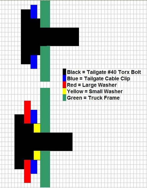

    The small washer goes on the threaded part, of the bolt that your tailgate cables are attached to. With the measurements that your read, this washer will fit on the threaded end and butt right up to the shoulder. All it does is extend the shoulder of that bolt, so when you tighten the bolt, it won't bind up the large washer against the tailgate clip. It's basically being used as a spacer, to compensate for the space taken up by the large washer which you will add, to prevent removal of the tailgate cable clip.
    Bottom line, just put the small washer on the #40 Torx head bolt, and put the bolt, along with the large washer back in place and tighten. Once tight, your tailgate clip should be free to swing in and out as you open and close the tailgate, and you shouldn't be able to remove the cable clips, because of the large washer. Again, this will only slow down the crook, and the idea is that he will move on to someone else, that has a tailgate that can be remove quickly and without tools.

    Okay, here's a diagram..........hope this makes sense. The top diagram is without the washers, the bottom is with both the large and small washer, in place.
    (see below - for diagram of explanation)
    If the yellow (small washer) washer wasn't in place, you can see that when you tightened up the #40 Torx bolt, it would force it into the truck frame, and then the tailgate cable clip would not be free to rotate on the shoulder. The small washer only extends the length of the shoulder, on that bolt. Hope this is clear, if not, let me know !
