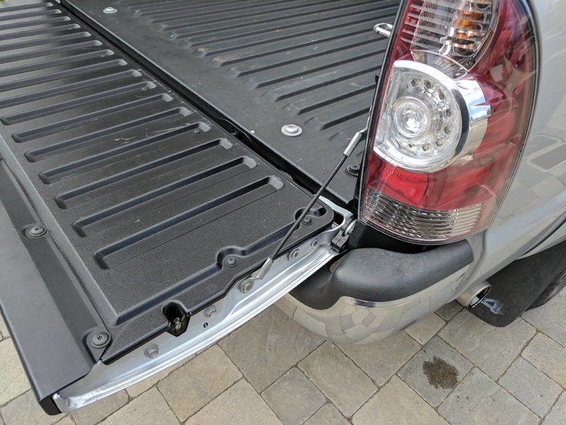

    I've pick up the Masterpro hose clamp with removable key from O'Reilly Auto parts for $3 and change.
    But turn out the size of the gate connection turns out to be about 1-1/2" in diameter. Went back and got the next size up, 1-1/4" to 2-1/4". So that's too big. Fortunately I was able image.jpg score the excess piece and break it off. But I noticed when I tried to put it on the passenger side of the gate, the top of the connection slants towards the gate, so when I tighten the clamp it slips against the side of the bed. Did anyone else has this problem with their 3rd gen Tacoma? Also are you putting hose clamps on both side?

    No, you only need to secure the one side. You can't do anything with the left side until you remove right side. There is also a POP&LOCK remote lock for your tailgate which I love, works with the rest of your doors or the drivers door depending where you wire it. When my doors are locked so is my tailgate, don't have to think about it. Love it.

    Trying to do the washer mod. What is the correct size washer/spacer, inside and outside diameter? How do I install the washer/spacer so that the cable doesn't bind. Pictures or videos would help out greatly if you have any?

    Go back here and start reading. This should clear up matters a bit.
    https://www.tacomaworld.com/threads/tailgate-theft-how-to-prevent-it.27829/page-50#post-11758928
    But, as for that small washer, it should have a 15/32" OD (outside diameter), with a 5/16" hole in the center (inside diameter). It should be approximately 3/32" thick, but never less than the thickness of the larger washer used. These measurements will mirror the 40 torx cable bolt, which has a shoulder that is 15/32" OD, and threads which that are 15/16" OD. This is probably not something you'll find on the shelf some where, but maybe(?) I believe it may have to be special made, if it is to be an exact fit.
    Understand, that whatever the thickness of your "large" washer, the small washer is there to compensate for that, and must be just slightly greater (thicker), but the same outside diameter as the shoulder, on the 40 torx cable bolt....
